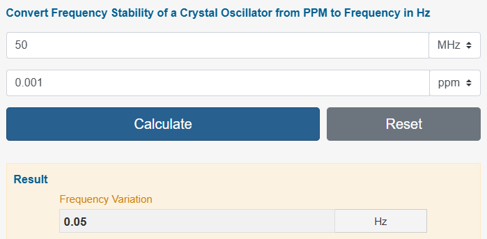

    Using an on-line calculator I get this:
    KD0RC Moderator
    Oh, right, .05 Hz!
