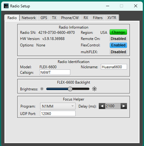

Did you press enter after you typed in the value? I just tested on my 6600 and no issues. I shutdown SmartSDR and restarted it and the port is as shown below…

Does SSDR use port 12060 for focus helper when N1MM is selected ?
AL, K0VM
The port is not hard coded. You can change it to any port you wish to use.

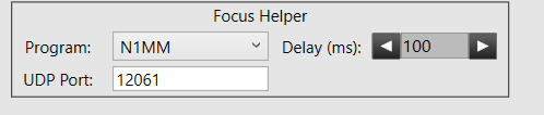

I just tried to change the UDP Port to 12061 in the Radio Setup menu. When I close and reopen the menu, the number is back to 12060.
Let me rephrase that.
When I close and restart SSDR the number is back to 12060.

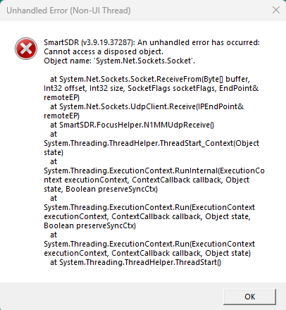

I now have a problem when I start SSDR I get an error. I changed the focus helper UDP Port to 12061 from 12060 for N1MM. Also, while running N1MM the focus helper does not work when I click something in SSDR
Hi Kent, do an export of your profiles, then perform a factory reset. If that doesn't solve it, submit a help desk ticket.
I created a ticket for this.
Thanks Mike
