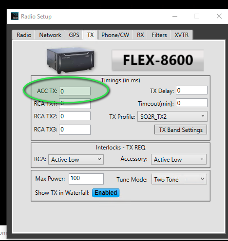

Okay. I am attempting to prevent hot switching. I found where I can delay the transmission (under the "Transmit " Maestro selection). Which may take care of the hot switching, but I also want the aux output to "hold off" releasing for a half second or so. I suspect it is possible, but I didn't find it. Any help would be appreciated!

    I thought this would work, but you can't program the delay to release.
