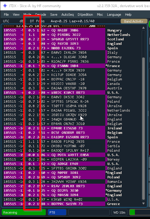

Firstly look to see what your the Lag is after a decoding period.
Mine -0.79 which means JTDX has finished decoding, processed the audio blocks, and has 0.79 second spare before the transmit period starts. A negative figure is ideal but up to 0.50 positive is acceptable. At this figure there should not be lost audio due to JTDX settings.

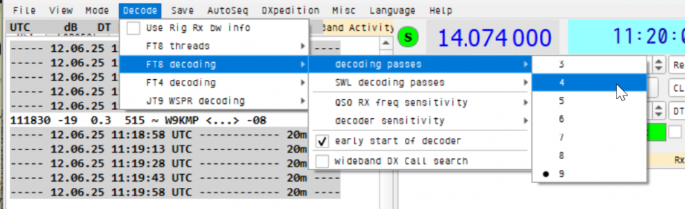

If a positive lag figure that is more 0.5 second is showing, the best bet is to reduce the number of decoding cycles
Mine is maxed out at 9 decoding passes per receive period because my computer can handle it and still give a negative lag. But when a computer is exceeding 0.50 positive, try reducing the number of passes. Try to retain subpass for decoding sensitivity but do not use SWL mode.

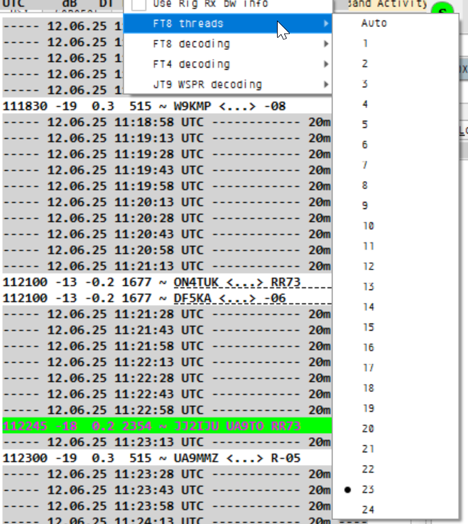

Another trick, less useful but you never know it might help, is to have JTDX use all but one threads available in the computer processor.
So if you have 16 threads, set this to 15. Personally I see no difference but the developers include this in case it helps.
