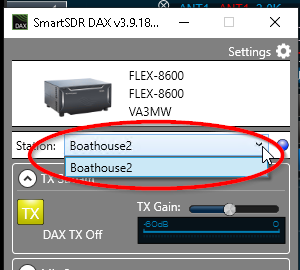

Mike-VA3MW Administrator, FlexRadio Employee, Community Manager, Super Elmer, Moderator adminOptionsHi Peter
You can still use your Maestro for 'command and control, but you then run WSJT on a computer with SmartSDR DAX (do a full SmartSDR install). Start DAX and CAT and then associated it with your Maestro.
Look here on both CAT and DAX (this is mine).
Yours will likely show up as Maestro (or whatever name you gave it).
That is how you use a computer to do your FT8 and the Maestro at the same time.
Give it a try, 73
