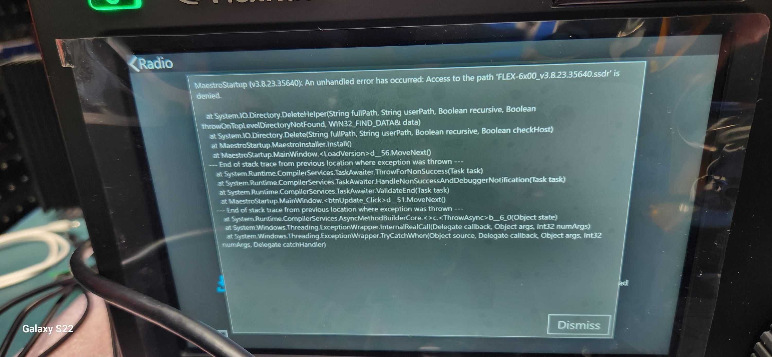

If you are attempting to update to v3.9 -AND- this is your first update on a Maestro or M model -AND- you get an exception like below, I have good news and bad news.
The bad news is that the update is not going to work without some extra steps. The good news is that once you have followed these steps, you won't have to do anything like this in the future. The steps are fairly easy to follow, but need to be followed carefully. The steps are as follows:

For the more technically inclined, this problem was caused by folder permissions setup in the Maestro/M image that prevented access to the folder that contains the radio firmware update. This has since been corrected in our image for new units, but this means that any units in the field that have this problem will need to use these steps the first time they attempt to update (and only that time).

I had an "unhandled exception" trying to upgrade to 3.9x. I then thought the logical thing to do was to try to downgrade. Got the same error. I'm now letting it cool it heals for 20mintues with the power cord disconnected. I'm hoping that this will solve the problem, but I'm a little skeptical. Not a confidence booster to have this happen the first time I try to upgrade the software in my Flex 8600M! — 73 de Carl N8VZ
Just to say my 8400M had the same issue when attempting the upgrade from the radio, i.e selecting the update from the version screen. If you did that, reboot the radio, update SmartSDR if not already done, launch SSDR and update from the radio chooser. For me this worked when otherwise all I got were variances on "unhandled exception" and "updater not found".
Erik: Please post more detail on what you did. I don’t know any other way to update than the update screen when using an M model. Tnxs for your help! — 73 de Carl N8VZ
Hello Carl. I don't know what to add. If you update ie download and install the latest SmartSDR version, and if you have not successfully updated the radio from the version screen, when you launch SSDR it will show the Radio Chooser boxes - one each for SSDR, CAT and DAX. In the SSDR box there will be a yellow 'UPDATE' button.
So for me, I had a new out-of-the-box 8400M. I had downloaded to Windows 11 the new SmartSDR. I powered the radio and the version selector window showed the new version. The update failed. First I had "unhandled exception". I powered off, unplugged, waited 10 minutes, tried again but got "updater not found". Repeated the power off /wait and power up. I launched SSDR, pressed the update button in the radio chooser and the update to the radio proceeded without issue.
Erik.
OK, Erik, I think you are talking about having a computer connected to your 8400M. At this point, I don't have a computer connected to my 8600M, but I do have a Maestro. I can try installing the new update through that. I'll let you know if that works. — 73 de Carl N8VZ
If that does not work for you Carl, open a Help Desk ticket. Flex will get it fixed for you.
Erik: Using your suggestion, and my Maestro, I was able to do the upgrade. Thanks for your suggestion! — 73 de Carl N8VZ
