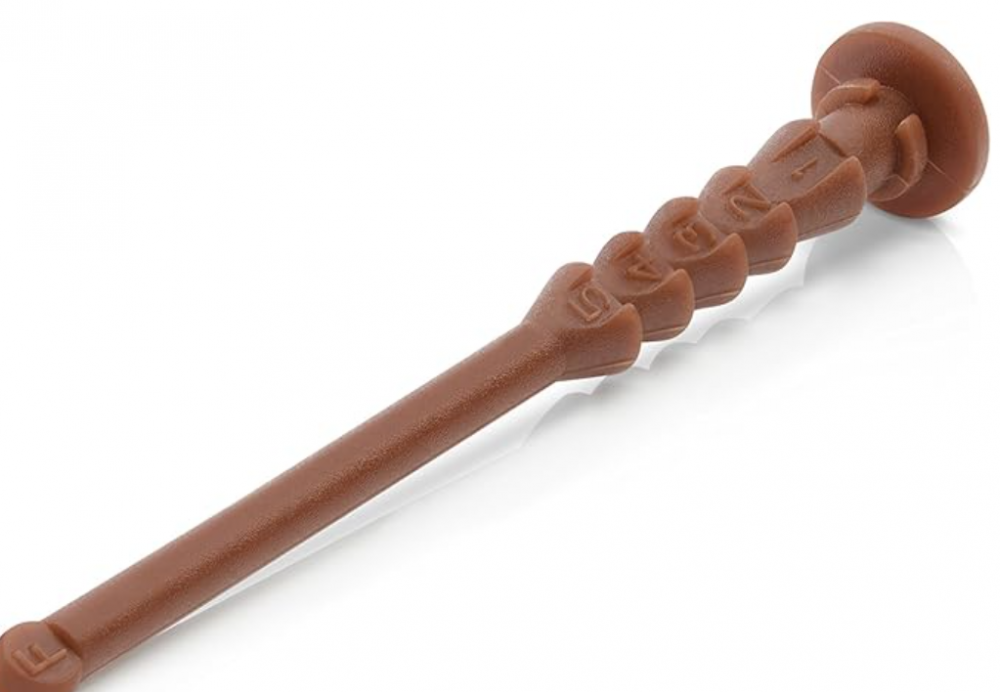

    This afternoon a kind soul emailed me this:
    "I had the same issue. I used the rubber fasteners that come with computer fans between the fan of my Flex-8600M and the metal plate to which it is attached (a little hot glue to ensure that nothing slips).
    I pushed a piece of thicker shrink tubing under the fan (middle of the fan on the base plate) I positioned the shrink tubing in the middle in front of the fan on the base plate with a long pair of tweezers, then lifted the fan slightly and pushed the shrink tubing underneath with the tweezers.
    This means that the fan does not touch the rear metal plate or the base plate under which the feet are fitted. I only hear a very quiet sound from the air flow. I did not just have high level noise but also clicking, humming and other noises. All these problems have disappeared."
    He also sent a picture of his amended fan mount which shows the use of these
    I have no idea how they fit but I found them on Amazon so ordered four. I guess I will figure it out next week after they arrive. I could sound off again about why do I have to do this with a 4000+ Euro radio barely out of its box. Few will care least of all Flex, for if they did they would never had let these issues happen and impact so many buyers. Mike MW though did email me personally bless him. This post is more for SIINC, because mentioned were noise and ticking, in case he wants to consider this fix.
    Meanwhile, so that I can actually use my 8400M without it giving me a headache (no exaggeration), I have temporarily put a large wodge of foam between the bottom plate and the desk so that the feet barely touch the desk if at all. What a difference that makes.
    Erik.
  • Trucker
    Trucker Member ✭✭✭✭
    Those will pull through the mounting holes on the metal panel that the fan is mounted on. The tapered end is pulled through the panel holes and the two holes on each of the four corners of the fan. The expanded part will pull through till it stops. Once all the way through, the fan will be tight against the rubber mounts and not touching the metal panel. I installed a new fan in my 6600M before I traded it in ( fan came from Flex Radio) and I used a pair of needle nose pliers to reach the tight places. You will have to remove both the top and bottom covers to get to the fan mounts. There isn't a lot of room to maneuver around. Be careful how you route the power cable so that it doesn't get near the fan blades. In the 6600M there was just enough room to route the cable under the rubber mounting on the top of the fan and then put the rest of the cable through a hole in a metal panel between the PA/ATU and over to the connection on the main board.
  • Erik Carling EI4KF
    Thank you, James. I understand your instruction and will be careful. 73 de Erik.
