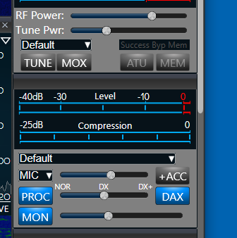

I am a new Flex owner, an 8400, and trying to get this setup for WSJT-X. And working with DXLab, WSJT-X and JTAlert like I had running with my old Kenwood 570.
In the DAX Control Panel, (running SmartSDR 3.9.18), the TX box for the TX Stream is not blue. It is sort of a Yellowish-green.
Hovering the mouse over the box yields this:
This channel is selected for transmit, the radio is trying to transmit, but the channel is disabled
You must enable the channel by clicking on the channel number
Where do I go to do that? Clicking on the TX button turns it grey and clicking on it again returns it to the same Yellowish-green.
Please point me in the correct direction.
Norman
KC9NVN0 -
In SmartSDR, on the right or left control panel side under level, compression Proc Mon, there should be a button for DAX, Click on that and it should turn blue.
Thank you, Ken - that is exactly what I needed. I was able to successfully make a few FT8 contacts.
Norman0 -
