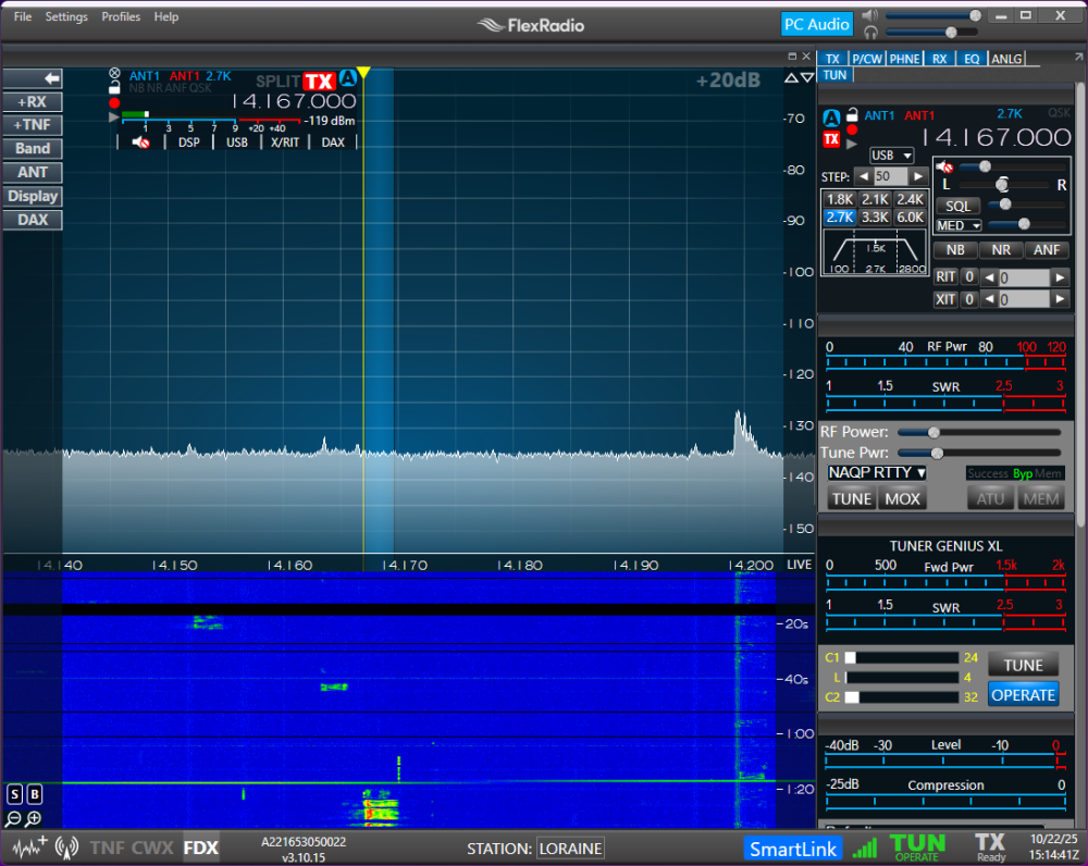

    Uploaded the waterfall and .WAV file renamed as .TXT so I could get it to upload. Not sure it'll work.
    I'm running SSDR remotely over SmartLink on new Carbon X1 laptop with business internet connections on both ends. Still have crackling in the audio stream presumably due to signal dropouts lasting on the order of milliseconds.
    When I listen to the DAX channel on Audacity there's much less of a problem. Still have some black lines on the waterfall but there is substantial improvement in overall audio.
    I've tried numerous suggestions from throughout the community and from the help desk for years and using Audacity is the only thing that has worked so far. I don't really like having to use 3rd party app for this. Also concerned in the future I could limit options for SO2R and other advanced techniques. One downside I've noticed so far is that using the PC microphone, the record feature on the slice doesn't work. And I can't control audio volume from the RX panel.

    I'm glad to see so much interest in this ongoing problem. The thing that has always baffled me and still baffles me, and the question to which I, and SQ2GXO have never gotten a satisfactory answer, is why are there no crackles when listening to the DAX stream or on a Maestro over the exact same networks? SQ2GXO went so far as to purchase a Mac and it worked on the same network. That's dedication but really shouldn't be necessary.

    SSDR Network Diagnostics have generally been Excellent to Good but this morning they are impeccable with 0.00% dropped packets (31/1,205,400).
