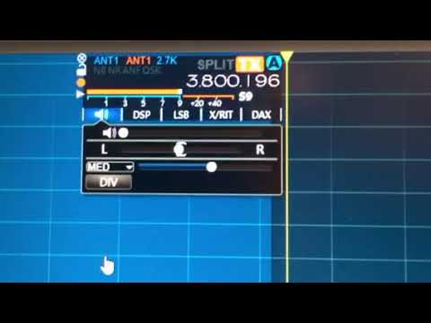

My step tuning is set for 100.   When I rotate the mouse wheel the radio will tune in 100 Hz steps.  If I place my mouse cursor in the pan adapter and drag the mouse I get random steps.  This is something that just started in the past few days.  I would like to have 100 Hz steps when dragging the mouse in the pan adapter.   Is there a setting to change this behavior?

    Here are my troubleshooting steps so far.  I have changed to a wired mouse and different surface (mouse pad)  No change in behavior.   I connected my Flex 6600 to a different computer.  Same result.  I have clicked the + a few times and my pan adapter is magnified to less than 10 Mhz.   At that point it acts the same.  Rolling the mouse wheel gets me 100 Hz steps.  If I click and drag, get lucky and try for 5 seconds or more, I can get back to the even 100 Hz frequency.  That's only if my pan adapter is magnified to an enormous range.   See demo of issue on youtube.

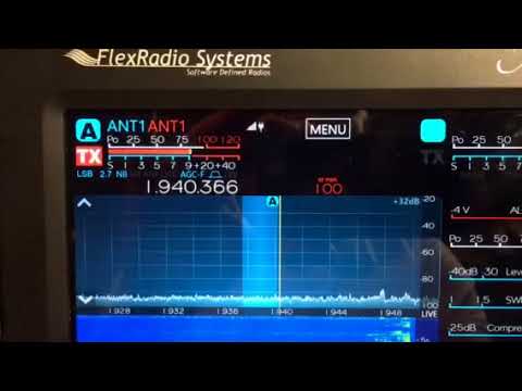

    Same issue is happening with Maestro.    Impossible to get VFO tuned to correct frequency.
