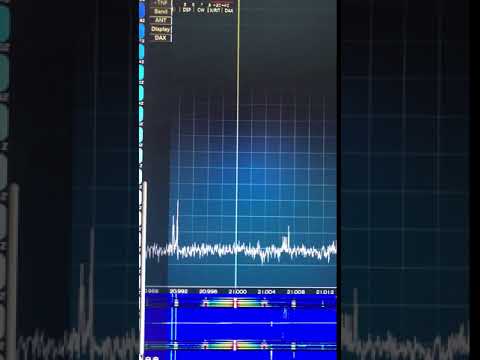

When operating cw I get two additional carriers. Exactly +4khz and -4khz from my tx frq. I have not seen this behaviour before... anyone knows what it is? Here is a short video of the behaviour: http://www.youtube.com/watch?v=Y6U0fKZLm2U 73 de Adde, SM0SHG

    I have not tried 15m but I don't see that when I transmit on 40 at almost full power.  But I do see something like that when I have a mis-match to my antenna.
    I assume you are using the monitor feature in radio setup "Show TX in Waterfall:"  If so I would not worry too much about it as it might just be seeing more than what gets out on the air.
    Best thing to do would be to have a close ham with a pan look at your signal.

    Mark is spot on with this Adde.  Artifacts you see in the TX monitor may not necessity reflex what is going on in the real world.  along with perhaps having a friend take alisten, Another thing that you could do is repeat the test into a dummy load, and see if the behavior changes.

    I would suggest you "pull down" on the scale on the right hand side of the panadaptor until peak signal is visible. Then look at how many DB down the "spurs" are from peak carrier.
    Every signal starts getting wide when you're looking 60+ db down from peak carrier.
