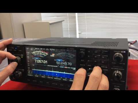

    Point and click tuning with a mouse on an external display. https://m.youtube.com/watch?v=r3MF3uwZuIQ&feature=youtu.be
