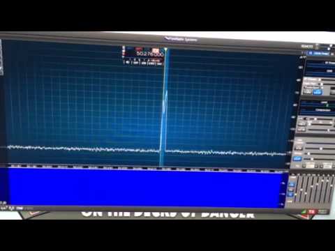

Hi. I decided to try installing 1.5 again after a factory reset of my 6300. The problem was exactly the same! I have done a quick video to demonstrate, sorry for the shaky picture but I was balancing my phone and a pair of headphones connected to another HF transceiver!
The audio really does sound this bad and I am not off-frequency. There is a loud pulsing background noise apparent as well.
