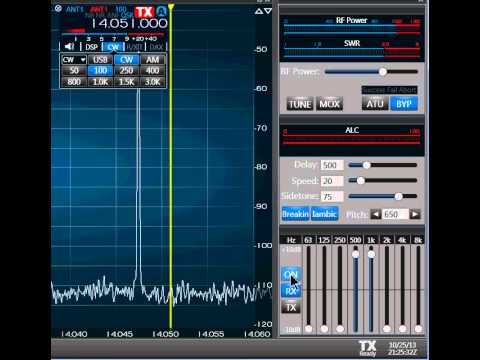

Here is a short video clip of the RX Equalizer used on CW as it exists today. You should be able to hear the difference when it is toggled ON and OFF.
http://youtu.be/Brrd8iA7AlA Regards, Al / NN4ZZ

AL, I like this idea better than the other one with EQ steps every 50 Hz. Tracking the CW Pitch is the way to go. I still think that 2 simple sliders, one for width (from 250 Hz to 5 Hz) and one for "Gain" (flat to 30 dB or 40dB) would be easier to adjust. Like this: [Break-IN] [Iambic] [Pitch] [< 650 >] APF Width..[150 Hz].....[250 : : : : : : [|] : : : : : : : : : : : : :5] APF Gain....[ 20 dB].....[0 : : : : : : :: : : : : : : [|] : : : : : : 30]0

Ken, I like your idea too. One potential downside is that is doesn't support the ability to negatively impact the frequencies outside the peaking range. (i.e. up to -10db for frequencies you don't want to hear) Another reason I suggested the same equalizer control was from a coding perspective it might be easier for FRS to implement it using the same control. So easier might mean faster to deliver and more likely to be considered. Regards, Al / NN4ZZ0

My assumption, perhaps poorly expressed, is that the "APF gain" control would simultaneously peak the desired frequency and cut the undesired frequencies. So if it was set for "10 dB" it would peak the center by 5 dB and drop the rest by 5 dB. A setting of "20 dB" should peak the desired signal by 10 dB and cut the signals outside the skirts by 10 dB, etc... until we get to about 30 or 40 dB total peak & cut...(or perhaps it should cut more than it peaks, perhaps a 1/3 by 2/3 split....so that raising the APF gain doesn't make the desired signal way too loud compared with the same signal without the APF?) Perhaps "APF Sharpness" would be a better term, so as to avoid confusion...0
