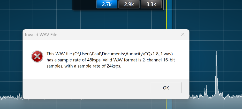

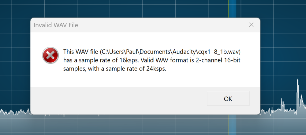

    Running 8600 v4.2.20 on win 11 pc. I have used Audacity v3.7.8 to record messages that
    I want to use with SSDR DVK. When I try to import one of the recorded .wav files, I get the first attached message. So I changed Audacity settings to 22050 sample ( didn't see 24k available )and 16bit format. When I tried to import that .wav file,
    I got the second attached msg.
    So I need some advice on what settings to make in Audacity — so SSDR DVR will accept them as an upload ??
