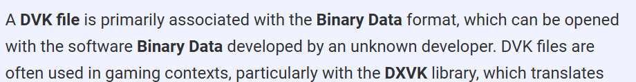

    Hi eyrich… what are you using the DVK file for? According to Copilot, it seems to be proprietary file format, mainly used in gaming…
    Did you mean you were trying to edit a WAV file?

    Another example of online AI tools guessing. Not sure what the search term you used. Think about it. DVK in FlexRadio terms is Digital Voice Keyer. I don't think FlexRadio named it Digital Voice Keyer so to align with a binary data format standard. Why can't AI just say, "I don't know", like my grandson started saying when he was one year old. Instead it spits out garbage disguised as an intelligent response but is just nothingness.
