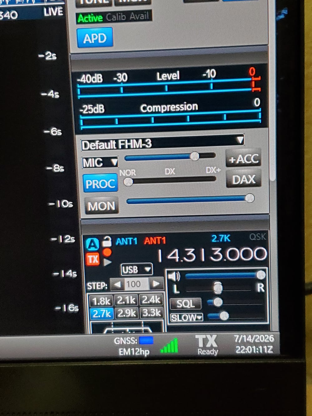

    Have you checked that DAX is off? Button to right of PROC in P/CW panel.
    Is the MIC selection drop down set to MIC? (in same panel as above).

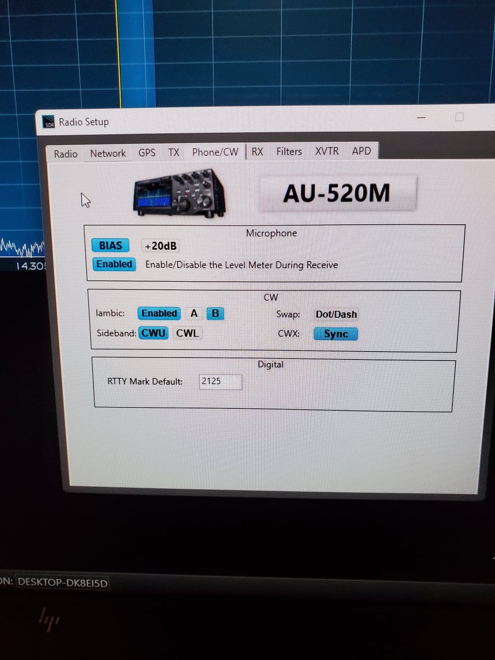

    The FlexRadio FHM-3 is an electret condenser microphone and requires voltage from the radio to function.
    • Go to Settings > Radio Setup > Phone/CW tab.
    • Ensure that BIAS is turned ON.
    • Note: If you need more drive, you can also toggle the +20 dB Mic Boost to ON in this menu.
    Is your Level meter moving at all when you speak into the microphone?

    DAX is off, BIAS is ON, and +20dB not recommended

    MIC input / FHM-3 profile
    Audio level on meter is VERY LOW...
