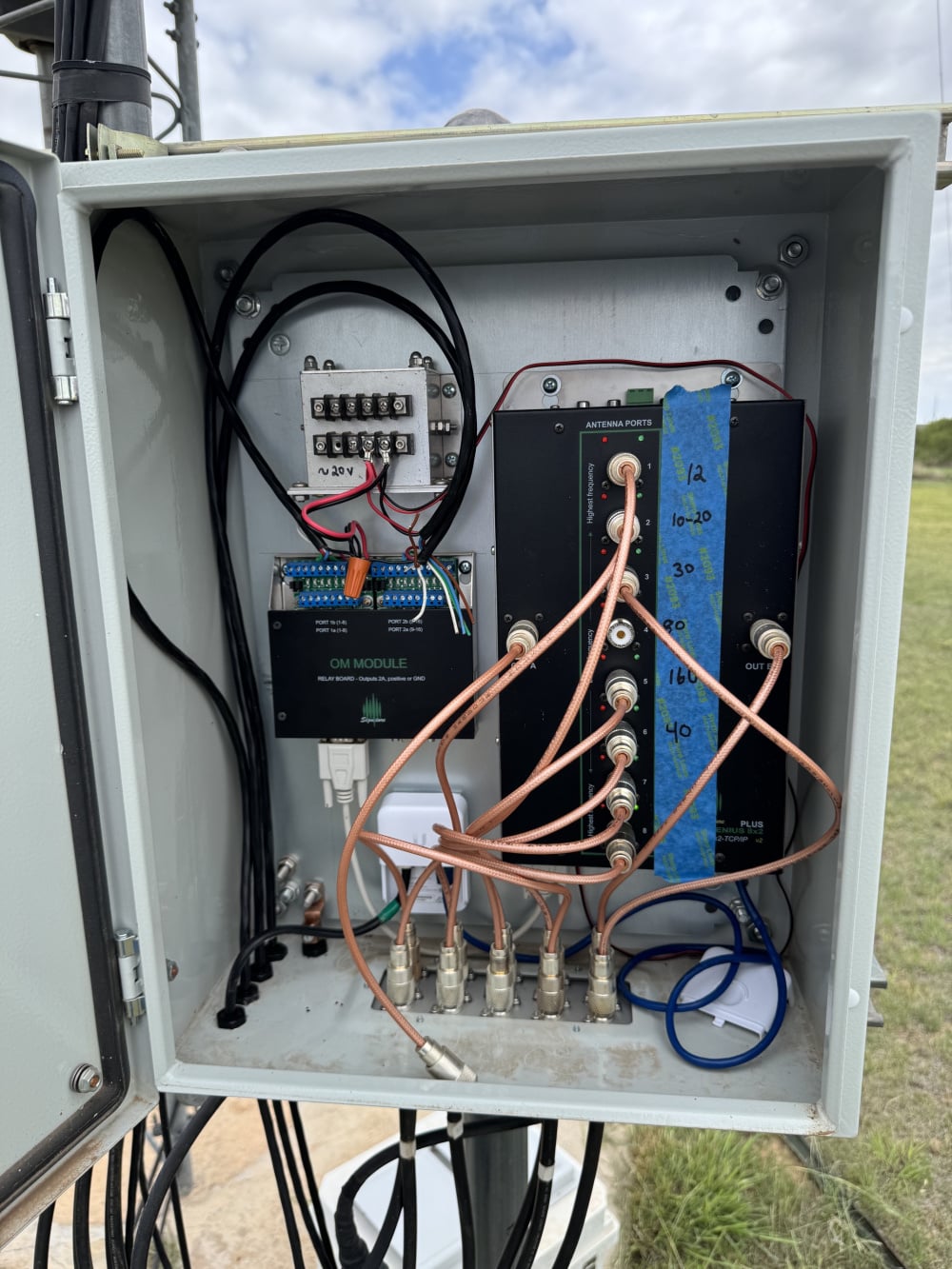

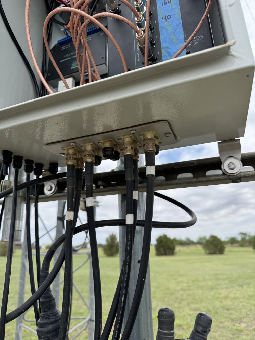

Dan,
I have two AG 8x2's installed in NEMA boxes along with an OM Module in each, one for each of my towers. When I get home I'll post a couple images here.
The NEMA boxes are steel Vevor boxes purchased on Amazon. I used front panel express and designed a new gland cover that holds 10 of these https://www.dxengineering.com/parts/dxe-uhf-fdfb-kit which handles the coax input/outputs. I built some RG-400 coax jumpers to go from the switch to the SO-239 bulkhead.
I currently use a couple different size cable glands for control cable and ethernet cables. If I do it again I would use a TY-28 bulkhead connector for the control cable and ethernet waterproof bulkheads for the ethernet cable.
I have not had any issues with water egress. It might be a good idea to drill a couple small weep holes on the bottom for any condensation to escape. I have not done that as my boxes are **** dry when ever I open them.
Rich - N5ZC
Here's a couple images. I need to clean things up a bit. The dust is in the case because the coax gland cover was not installed for a few weeks.
Rich - N5ZC
