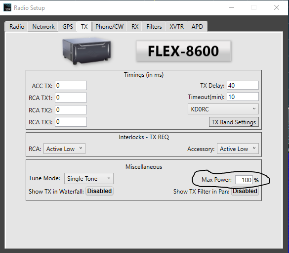

yes i thought the same thing; aurora uses % NOT WATTS like the 8600M!!
I believe they are both in percentage. Nowhere is there a statement that the numbers on the scale refer to Watts.
I see… Thank you. That explains everything. I mostly use the Maestro, which does not display the percent sign in the TX Band Settings, as the SmartSDR software does.
