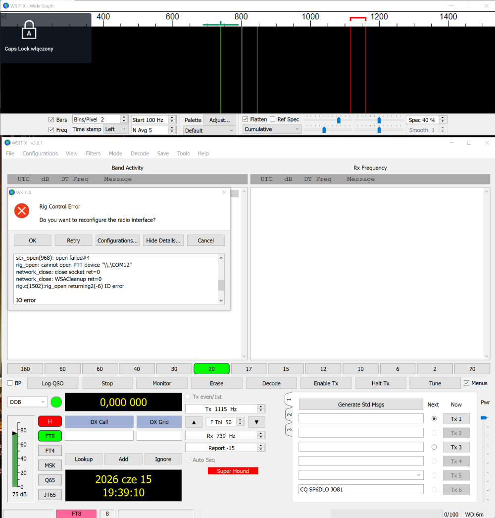

Now it finally works with receiving the signal, thanks to EI4KF. Must've eyeballed the settings before. Now the issue is different (as in attached image), the signal is received, but it shows an "Rig Connection Error" and doesn't read the frequencies.
