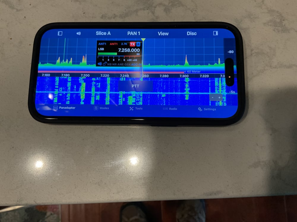

Mike FYI, The setup and install you did for me this weekend is working perfectly. I use it on my iPhone with both the 8600 and AU520. Version 4.2.18. Windows 11
Thanks for great job.

did you conerct direct to 8600? with Iphone not using windows?
try that and report back
/Lars SM4IVE
Lars, yes I connected directly to the iPhone to the 8600 and also to the AU520, both radios on the newest SmartSDR version.
SmartSDR was not running but it works with it running also.
I turned the Wifi off on the phone to be sure it was using the outside network.
This is the first time I have been able to remotely access my Flex radios!
