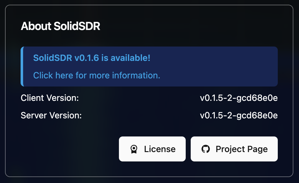

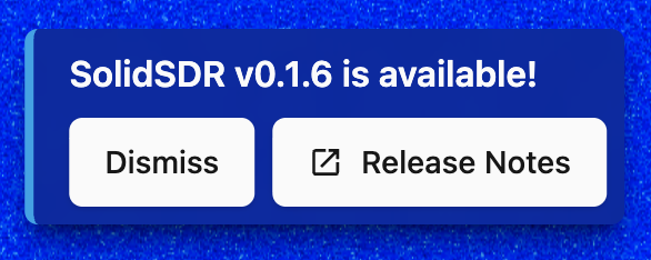

    SolidSDR v0.1.6 is available!
    https://github.com/daveisadork/solid-sdr/releases/tag/v0.1.6
    New in this version is a notification when a new version is released:
    As well as a new "About SolidSDR" card in the App Settings dialog, which reports the client and server versions, and contains links to license information and the project page. New release notifications will also appear here when a new version is available:
    Since new release notifications now live in the app, going forward I won't repost release notifications here unless there are large new features or big changes.
