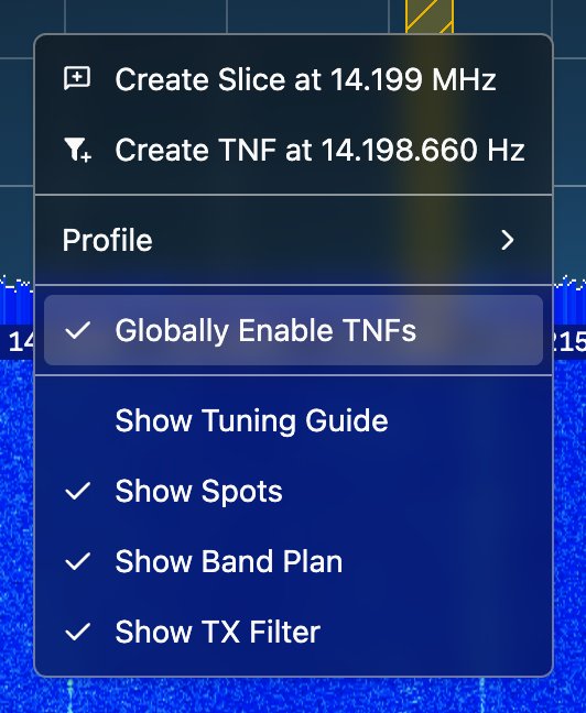

- Adds a new Profile Manager Dialog
- Adds a new Profiles section in the panafall context menu for saving, creating, or selecting global profiles. The panafall context menu is accessed by right clicking (or long-pressing on touch devices) in the panadapter or waterfall.
- Adds dropdown menus next to the TX and Mic profile selections in the radio sidebar for profile management, along with a new indicator when a profile has unsaved changes.0 -

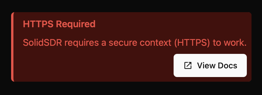

This is a screen shot of the web page I see on other PC's on my local network:
Ian G4ZJH.

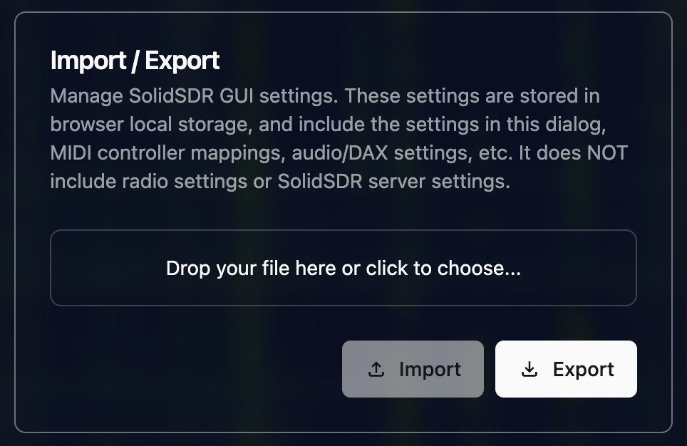

SolidSDR v0.1.3 is released!
https://github.com/daveisadork/solid-sdr/releases/tag/v0.1.3
New in this release is the import/export dialog for backing up and restoring radio data.0 -

Typing in http://debian.local:8080 on another pc gives me this result:
Typing in https://debian.local:8080 returns this screen:
https://debian.local also returns the same screen as above.

Don't use the :8080, just https://debian.local0
unfortunately typing in https://debian.local still returns the same message as https://debian.local:8080

Adds a new import/export section to the app settings dialog

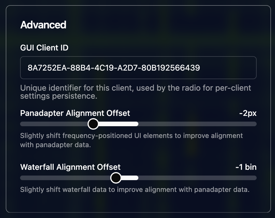

Adds a new "Advanced" section to the app settings dialog

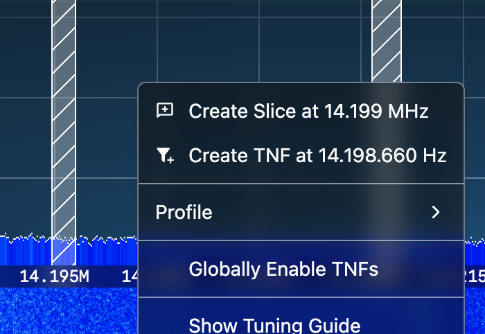

Adds a global TNF toggle to the panafall context menu
TNFs are now rendered with a distinct color when globally disabled.

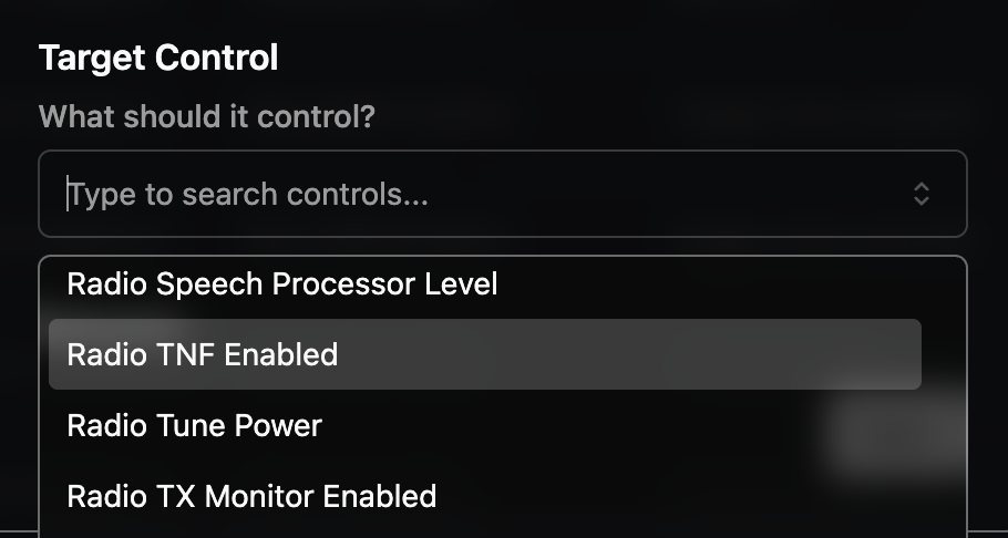

It's now possible to control TNF enablement with a MIDI controller.
New in this version is some error messaging around Secure Contexts:
The message includes a link to the new Wiki pages:
