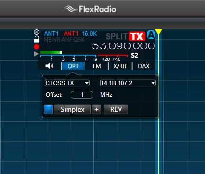

Trying to set up for local 6 Meter FM Repeater.
Have entered all the necessary info on ANT 1A Xmit, and ANT 1B for RX only.
SDR indicates NO TX bottom right corner.
Have watched several videos on proper set up for 6 Meter FM Narrow, but nothing has helped.
I suspect problem is simple, but cannot find it.

Hi Phil, to use a repeater, you do not need two slices. Open the OPT dropdown and set your transmit tone (if any), your offset (the example below shows a 1 MHz offset, yours may be different) and the direction of the offset (most will be minus).
When you transmit, the frequency on the slice will not change to indicate the TX frequency, but if you make your panadapter wide enough to cover the TX and RX frequencies, you will see a spike in the panadapter where you are transmitting.
Give this a shot and if you have problems, post a screenshot of your SmartSDR screen.
