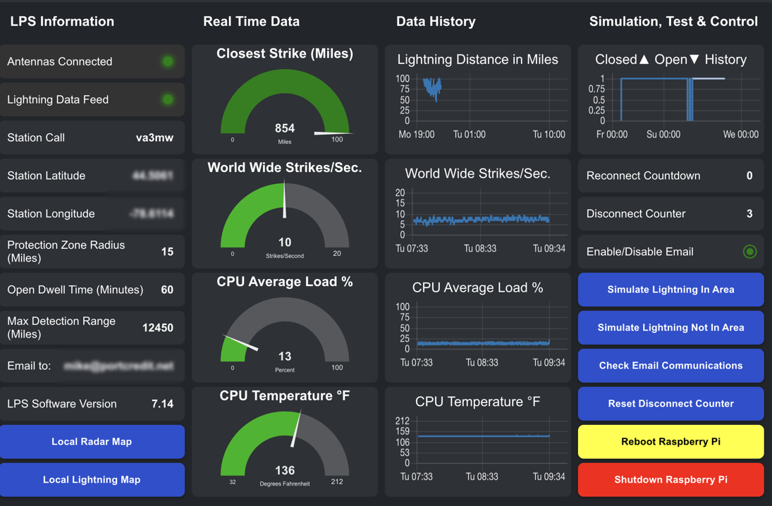

    I built this. Disconnect with 8 N connectors and one rotator connector. Provides 7" air gap. Designed and built the controller, wrote the firmware, and a server app running on a RPi that provides a web page for remote operation and real time streaming switch position updates.

    It was cool to see that while I was away for a week at Dayton, that the automation kicked in 3 times. Since we needed all the radios for remote Hamvention demonstrations, I had to leave them connected.
