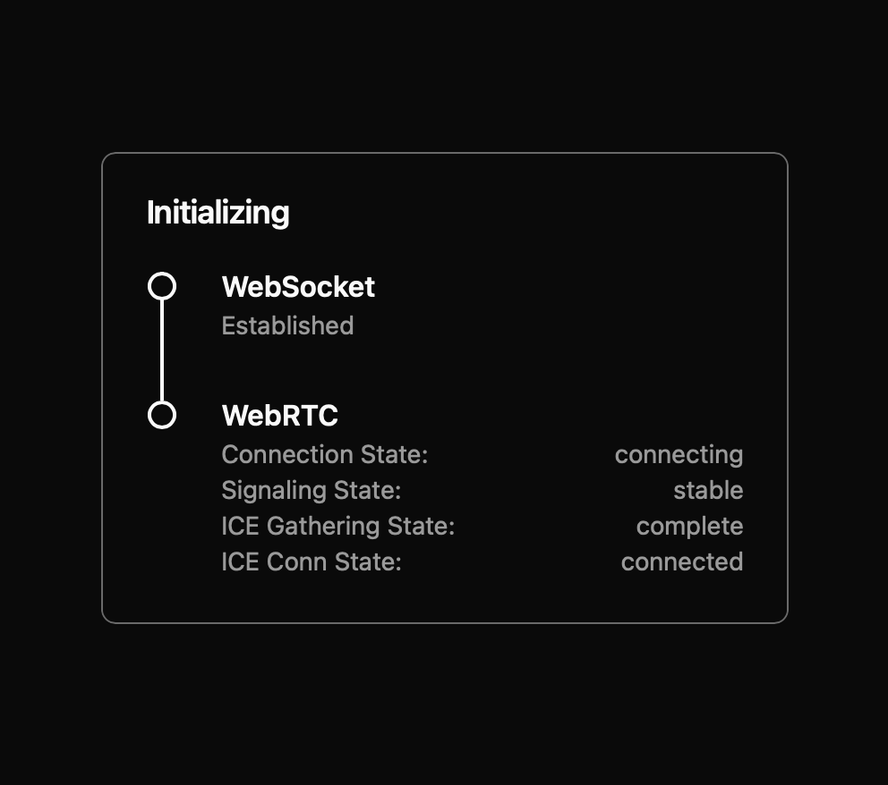

    I think i'm nearly there… Installed both SolidSDR and Caddy on my Debian machine. Caddy seems to run fine, but on another pc's web browser I don't get the radio display. I think the server isn't running properly. This is its output when I run it:
    ian@debian:~/Desktop/solid-sdr-server_0.1.2_linux_amd64$ ./solid-sdr-server
    2026/05/15 11:54:15 [config] http=:8080 static="" ice=50313..50313 api-log="messages.txt" file=""
    2026/05/15 11:54:15 [rtc] failed to create UDP mux on port 50313: listen udp 192.168.1.136:50313: bind: address already in use
    I think Caddy is running, as on another pc, when I enter debian.local:8080 I get a black web page with a test box in the middle stating its 'initializing' - Websocket is established, but for WebRTC the connection state: is connecting. The web page title says 'SolidSDR'.
    I'm sure my issue is a typo, or that I just don't know enough Linux to see where the problem is!
    The server must be running as I can see the radio display on the web browser of the machine running the server when I just type in localhost:8080.
    Maybe I'll just wait until this issue of serving the webpage via https is resolved in a later release - as for my use case, I would like to access the radio on machines other than the local one.
    Anyway, thanks again for bringing this to fruition - I'm sure I will solve this issue eventually!

    This is a screen shot of the web page I see on other PC's on my local network:
    Ian G4ZJH.

    It sounds like you already have an instance of solid-sdr-server running (otherwise you wouldn't get anything from http://debian.local:8080), and it's just failing to start up a second copy because the port is already being used. If you have Caddy running, you should be able to get to it at https://debian.local (without the :8080, as that will just hit solid-sdr-server directly and not go through Caddy).

    Right, I've rebooted my Debian box, and checked both caddy and Solid SDR are running without errors.
    On this same machine I can access the radio going to localhost:8080.
    Typing in http://debian.local:8080 on another pc gives me this result:
    Typing in https://debian.local:8080 returns this screen:
    https://debian.local also returns the same screen as above.
    I'm at a loss to know what to do next, so unless I discover my error, I'll just have to accept this won't be working for me until you add a way to make serving the page as a https:// built-in, unless anyone out there has managed to get this working for them….I would love to know how you did it!
