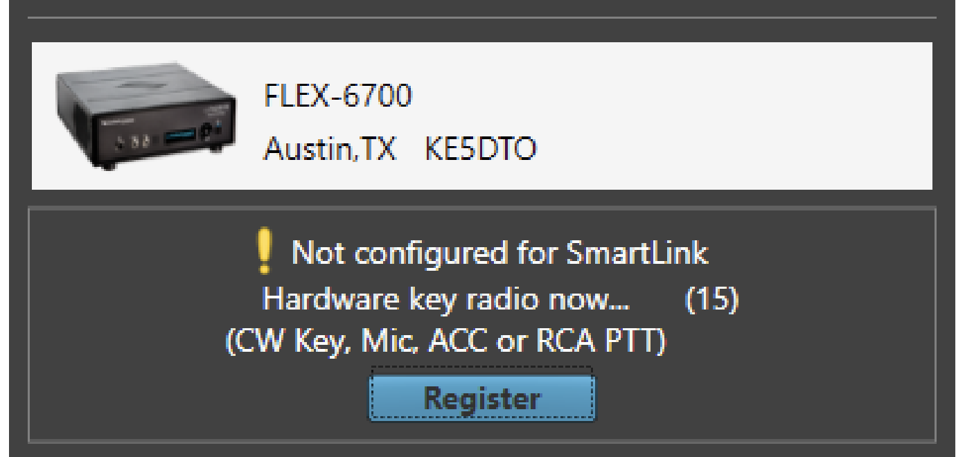

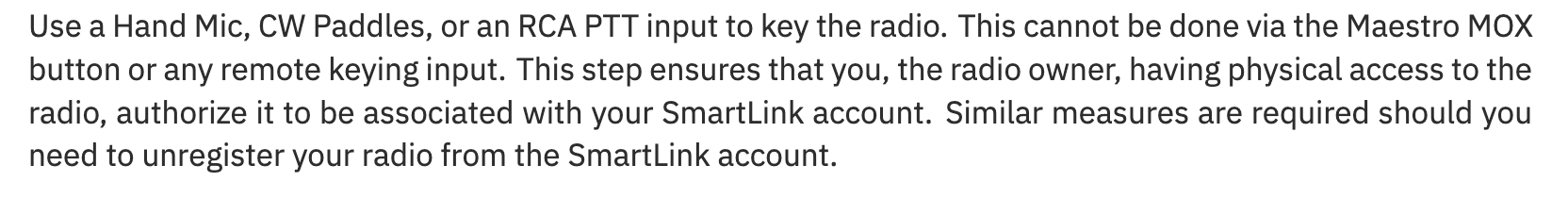

I answered this in another posting, but it sounds like you have not done a hardware registration on the radio. See chapter 9 of the SmartSDR manua.

Thanks my friend, but I have done that. The radio is registered and my call sign is on the screen and the green check mark is on the screen. I think I am not putting in the right ports in my router. I have tried 4993 and 4994 and 21000 22000. Still not happy somewhere.
