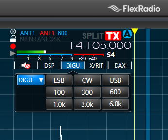

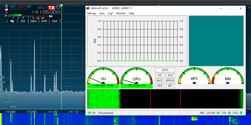

In the very limited testing that I have done, everything seems to be working great except for the offset in the digital modes. There used to be a 1500 Hz offset default when in DIGU. The option for the offset is either gone, or I can't find it. The result is that the VARAHF modem is listening 1500 Hz low, and obviously, won't decode anything.
I can zoom way in and drag the filter skirts to 1200 Hz and 1800 Hz and get back to OK, but this is an awkward work-around.

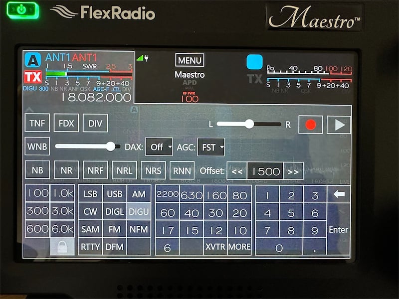

    Well the digital offset is still availble in the Maestro:
    But I can't find it in SmartSDR for Windows, only the RTTY offset. I wonder if anyone else can find it? I hope this isn't another example of Flex accidentally losing controls again 😀
    I think the problem you are seeing is that the new filter presets are wrong for DIGU (and probably DIGL), so if I click 300Hz bandwidth it centres it at 150Hz instead of at 1500Hz. But on the Maestro I can then tap the offset up and down to recenter it.

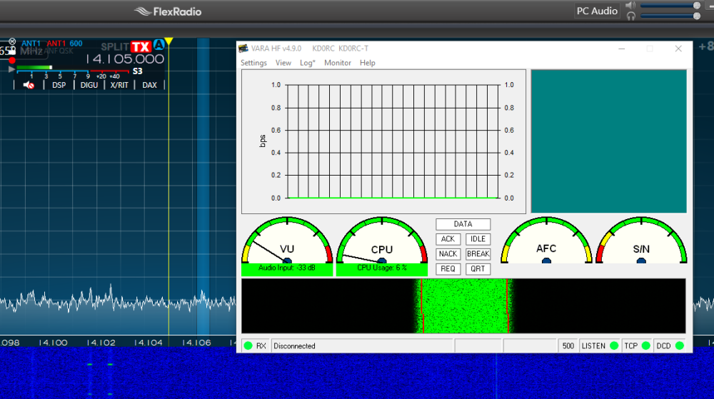

    Hi Jonathan, I suppose it is not actually needed if you can easily set the high and low cut filter frequencies by mode. I will give that a shot once the 30 day SmartSDR+ waiting period is over.
    For now, I may just leave it at 3.0k which will center it properly without having to mess with the high and low cut values.
