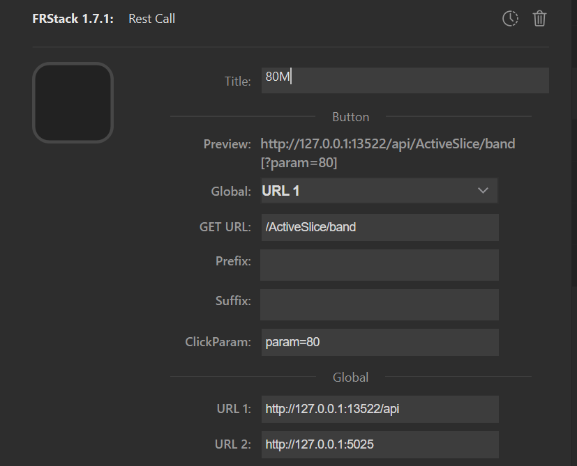

I just received my FLEX-8400 (super excited!). I'm playing around with FRStack (v 4.0.0.5), and I don't see any command with the Stream Deck plugin to set the band. I can do a command like this in the browser and it works fine:
http://localhost:13522/api/ActiveSlice/BAND?param=20
I also saw this in the version history, but I don't see this in the UI:
Version 3.8.16.82
Add Band change UI
Can anyone help?
  • Erik Carling EI4KF
    Answer ✓
    I must confess I am missing something in your question. Any command you can action via a browser, you can add to a button in SD.
    So I presume there is another issue. Can you elaborate?
  • dlmorgan999
    dlmorgan999 Member
    Thanks for the response. I thought for sure I had tried that, but I must have done something different, because it's working now.
