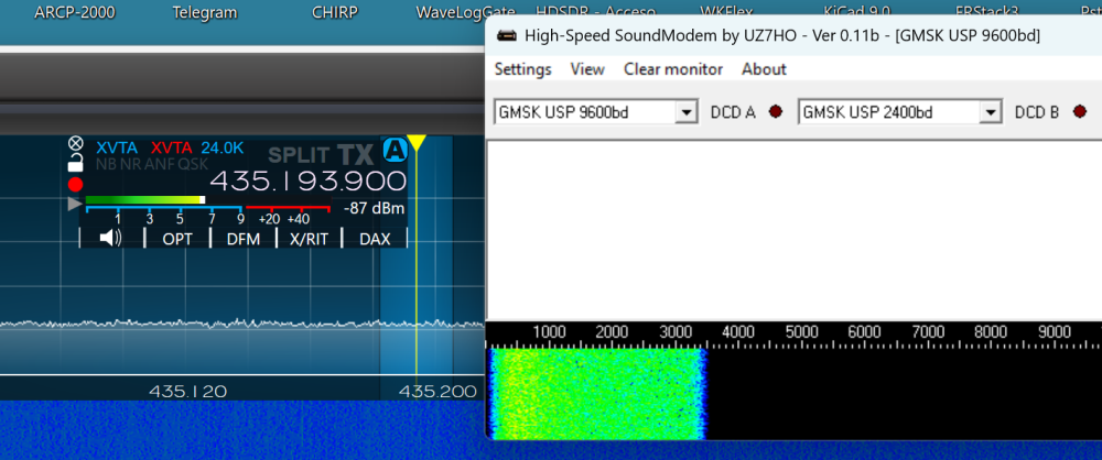

Running the latest version of SSDR on a 6600M I have found what appears to me a DFM filter issue which can be seen when using the UZ7HO high speed sound modem software monitoring the open squelch audio stream. If I preselect any filter width and go to DFM the filter opens to about 5400 Hz if I select any other DFM filter width the filter closes to about 2700 Hz and can't be opened up without going into FM mode and then back to DFM. Also why does the DFM filter selection have eight options but really there is only one selection available?0
The filter window size changes in SSDR but not in the actual audio stream which made me think it was working but checking the audio stream it appears to not actually widen to match the filter size chosen.0

Still strange the DAX audio output in DFM….. Acording to the information is 24kHz but on hs-soundmodem I only have 3,5kHz… Anybody could explain it to me? Why not a WFM mode or similar?
This problem prevents me from using my Flex 6600 to receive telemetry data from UHF satellites.
