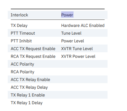

When you setup global profile, is the power setting selected not saved too? When I change to a different profile, it seems the power setting stays at what I was on prior to changing profiles.
    We have a brand new SmartSDR manual (just saying that as I was reviewing it).
    The details are in section 19.
    Power is part of the TX Profile.

    To confirm I understand correctly, when creating a Global profile, the power setting does not save, the power setting only saves when creating a Transmit profile?

    The Global profile loads the associated Transmit profile.
