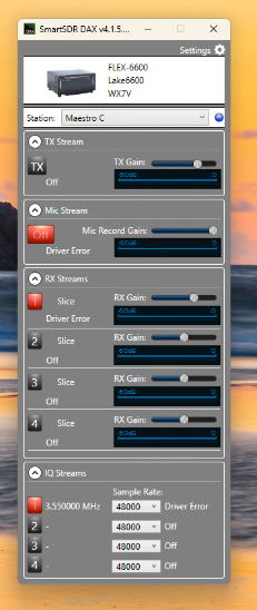

I'm getting the Driver Errors since this last weekends windows security update. I've manually uninstalled and reinstalled the drivers several times. I've had a help desk ticket opened 4+ days. Core Isolation (Memory Integrity) is off and has been off for a few years since this was reported in 2022.
Short of trying a fresh install, does anyone have any other tips or tricks to try?
Happens with the Maestro connected, and with SmartSDR 4.1.5 running locally with the radio.
Chris de WX7V
