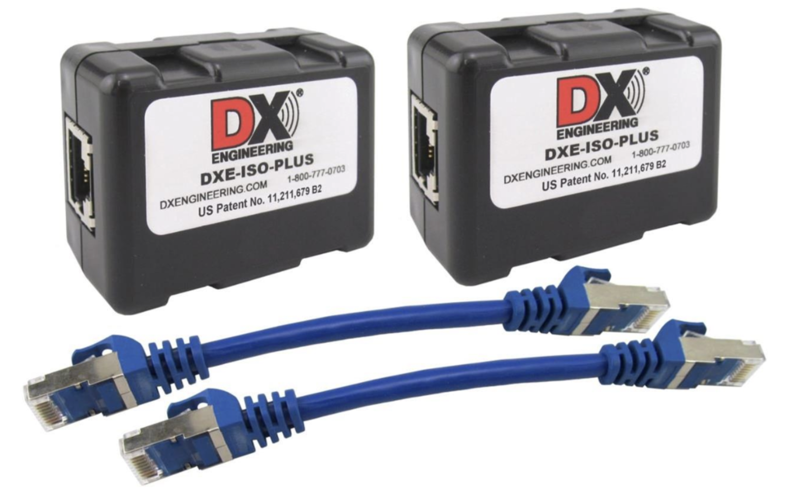

    For Mike, the DX engineering devices are just back to back wired ethernet transformers. You can make these yourself for a few dollars…. But not enough…
    Fiber works.
