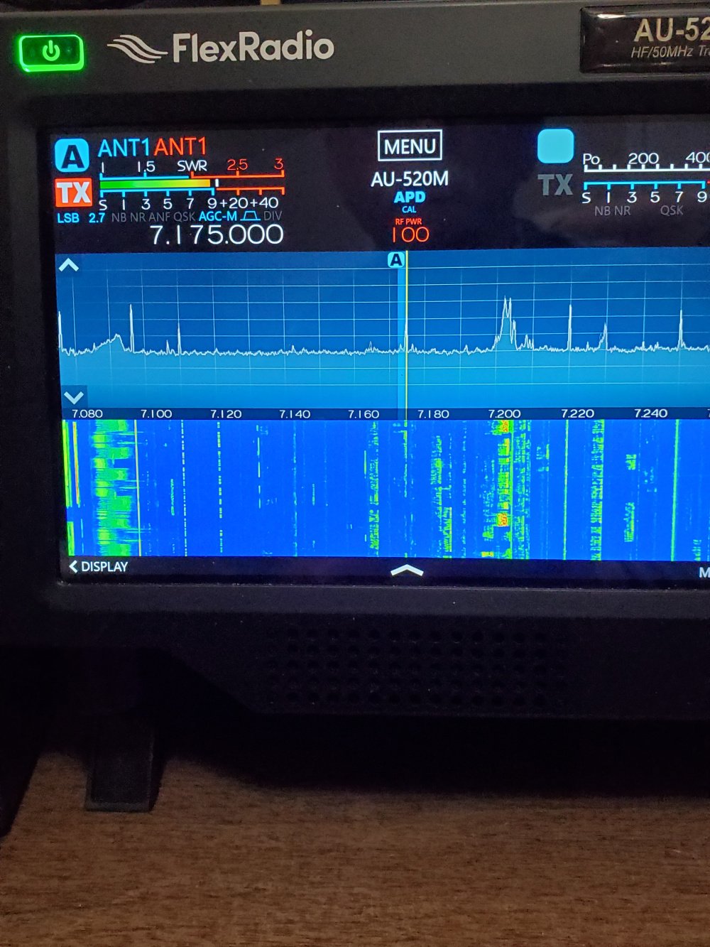

    This is what your main screen should look like.

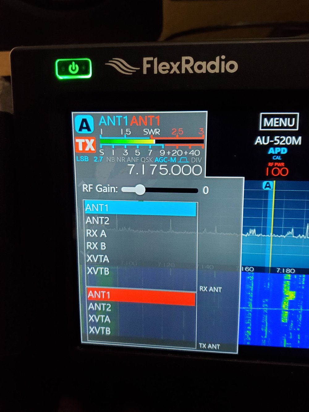

    And the buttons above the main vfo knob should look like this:

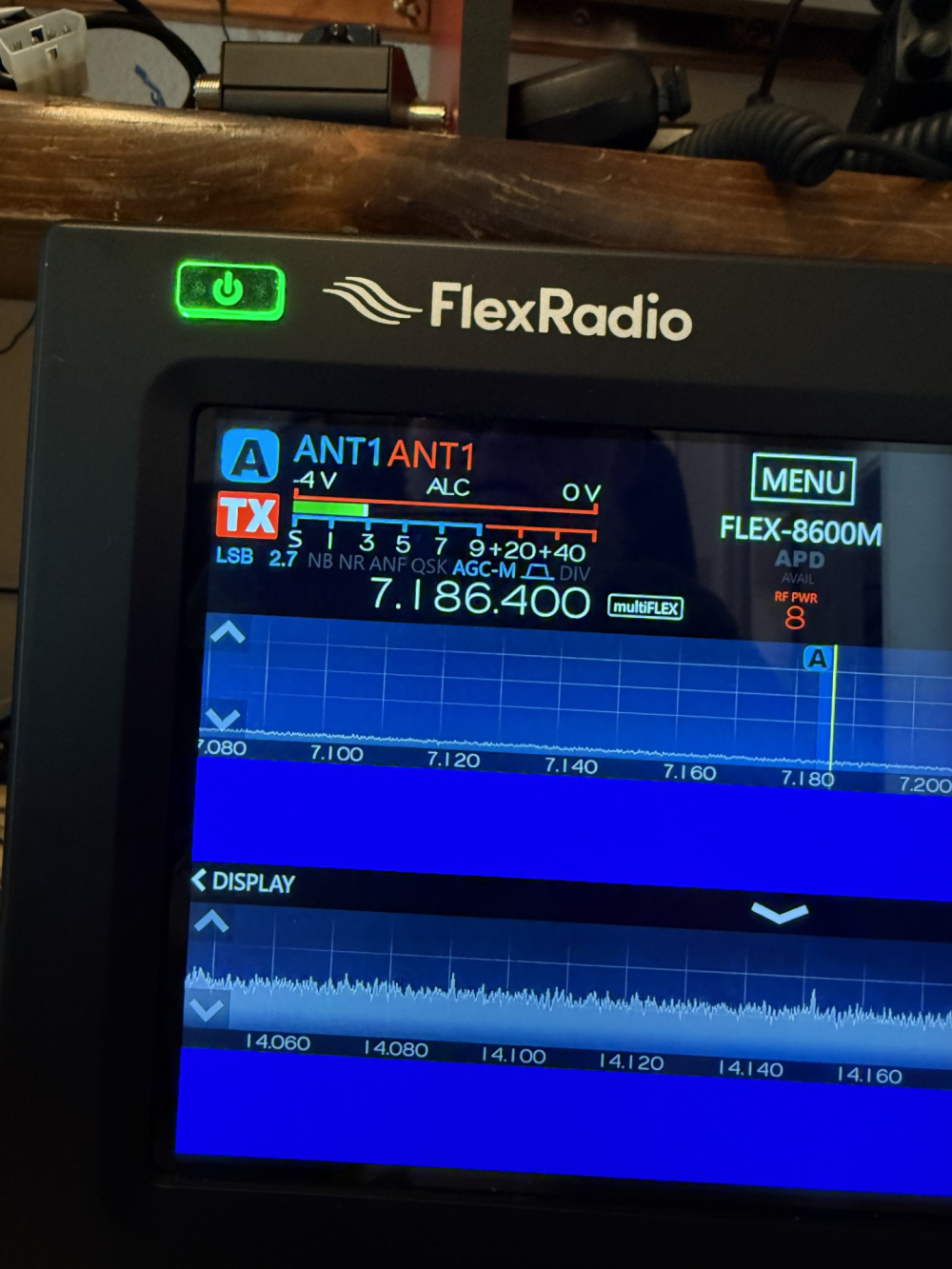

  • Ruarto
    Ruarto Member ✭✭
    I am getting sound out of the front speaker on the 8600M, just static.
    Your pictures are just what I see EXCEPT, no waterfall, no signals showing. Its as if the antenna didnt exist. I put 50 Ohme dummy on 2 got same, zippo. Do you think its possibly not connected inside the case or something?

  • Ruarto
    Ruarto Member ✭✭

    Does your front screen look exactly like this?
    The Antenna selection should be for the same Antenna unless you are using two different antennas. One for receive and the other for transmit.

    Connect your coax to the Antenna 1 connection on the rear of the radio. Then, touch the area at the top above the frequency display and above the meter. Just barely under the edge of the case edge around the display panel. You should get the big menu to select the transmit and receive Antenna inputs. Make sure that they are the same. Ant1 in Blue ( receive selection), Ant1 in Red ( Transmit selection) .
    In addition to this, make sure that the Antenna you are using is setup for the band you are using. If all else fails, go to Flex Radio's website and open a Help Desk ticket. They will be able to determine if there is a problem with the radio itself or a hardware/software configuration problem.
