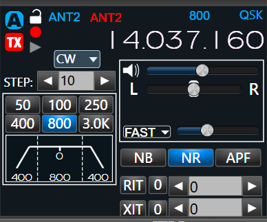

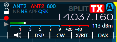

    Hi Ruarto… I'm assuming that when you say the '…ant light is red..' you are referring to the ANT identifiers on the Slice Flag
    Or the entry in the menu on the right side of the screen
    If so, these are simply identifying which antenna has been selected for Transmitter (TX) output. In the case above, I use ANT2 for both Receive (blue) input and Transmit (red) ouput. It is possible (and sometimes I do that as well) to select a different antenna for input or output.
    Is that what you are referring to???

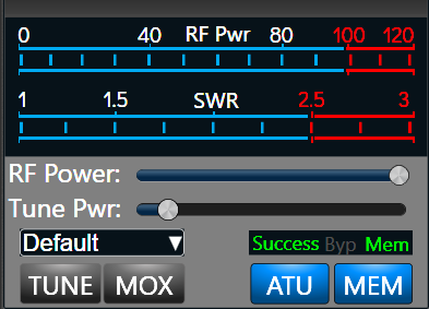

    As far as not getting any power out, how are you determining that? Is there nothing showing on the RF Pwr meter when you transmit? Have you tried trying to transmit into a dummy load?

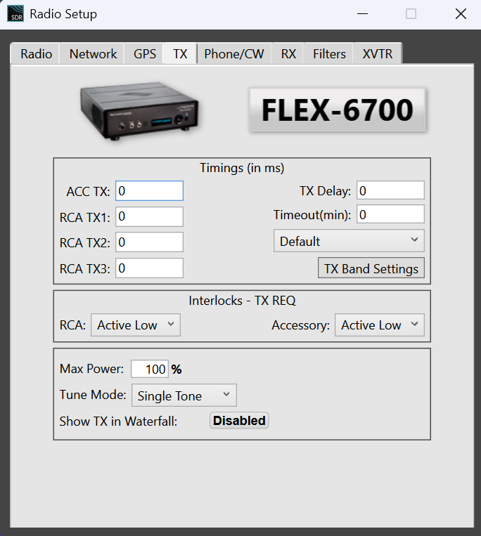

    Under Settings/Radio Setup/TX tab, what is Max Power set to?
    Also, what is the RF Power slider set to on the side panels?
    As in mine, it should be all the way to the right.
