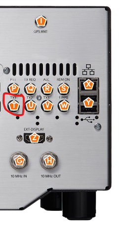

RCA cable from TX1 of radio to PTT In on amp.

"RCA cable from TX1 of radio to PTT In on amp."
On 8600M I dont see a tx1, perhaps the TX REQ? white, or red avail.
On Amp there is Key in and Key out only. IC7300 used KeyIn so I will assume that is equiv to PTT. willing to try.
