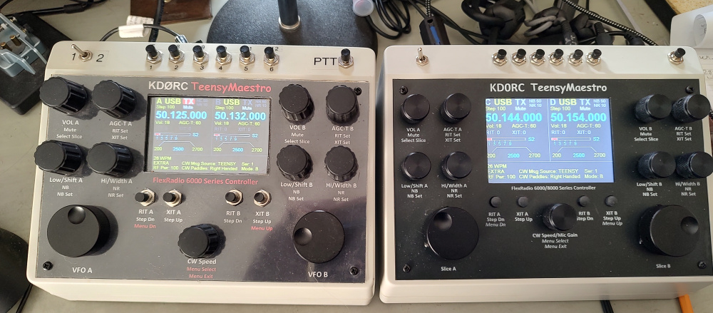

    I added a menu item to choose which slices to display. I also compiled it for HW version 1. Here is V 2.003 Beta 4. I anticipate this to be the last beta version before releasing to GitHub next week.
    Hardware Version 1:
    Hardware Version 2:
    Now I can control all four slices with a pair of TeensyMaestros! If I only had enough desk space, I might actually do this…
    multiFLEX also works properly now. You can use a menu item to select which station to bind the TeensyMaestro to and it will only control that station.
