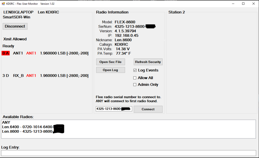

    You can start the utility without a file, and it will create it for you. Then, use the Open Sec File button to edit the file.
    Here is the latest file that I have. The station name must start at the beginning of the line. All other parameters can be in any order. Anything after a semi-colon (;) will be ignored. This makes it easy to temporarily suspend connection privileges just by commenting out a line.
    ; this is a comment
    LENBIGLAPTOP, admin=yes, xmit=yes, call=Len KD0RC, ; anything here
    LenBigLaptop, admin=yes, xmit=yes, call=Len KD0RC,
    LEN-LAPTOP, admin=yes, xmit=yes, call=Len KD0RC, XXXXX-XX-XXXX, xmit=no, call=Simon NV0E,
    XXXX-****-PI, xmit=no, call=NV0E,
    XXXXXXXXXX, xmit=no, call=Simon NV0E,
    With this setup, I can easily keep everyone (including my good friend Simon) out while I am operating or possibly doing some utility testing. I set myself up as admin=yes, then just click the Admin Only button.
    For our local club station, the station manager has the Allow All box checked so that anyone with the SmartLink credentials (i.e. club members) can use the station. As they connect, their station names will be captured in the log and later copy/pasted into the security file. Once the first wave of club members are in the file, the Allow All checkbox will be unchecked. Going forward, club members will be instructed to connect via SmartLink, then post a note to the club manager asking for permission to use the station. At that time their info can be transferred over to the security file.

    Len, I've messaged you v1.03 zipped, the Help and FAQ briefly explain use and known limitations. Not sure if you had a chance to look at previous version so won't go into any details here. Below is an example of a 6700 connected.

    Is anyone else using FlexUserMonitor for a club or personal station? I would be interested to hear how it is working for you. We have it in "Allow All" mode right now for the 285 TechConnect Club to gather station names of club members. Next week we will lock it down. Going forward club members just need to submit an email to the station manager to get access.
    I have been using it at my home station to control access to my 6400 and 8600. It has been a great way to show friends how the new SmartSDR+ noise reduction works so that they can decide if they want it or not. I also let folks connect so that they can test drive my Flex to help decide if they need one in their shack.
    The biggest use lately has been so that Simon, NV0E can use my rigs to test out his new SmartSDR for Linux (or whatever it will be called…) using SmartLink. So far, it is working really well!
