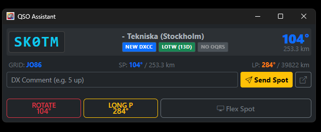

      THE QSO ASSISTANT (FLOATING COMPANION)
      This has become a favorite for many operators. It’s a compact, floating window that sits alongside your log and offers:
      - Unified Lookup: When you type a callsign in Wavelog, the Assistant instantly fetches data from both your local Wavelog history and QRZ.com.
      - FlexRadio Spotting: A dedicated button lets you send the looked-up callsign directly to your FlexRadio panadapter as a spot.
      - Visual Info: View bearings (Short/Long path), see the operator's photo/map, and check if you need the station for a new DXCC or slot.
      - Direct Control: Features a "Send to DX Cluster" button and can even trigger your rotator directly from the assistant.
      Below the QSO Assistant in compact dark mode without profile image or map (all configurable)

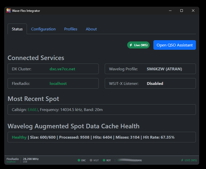

      Below the Status Tab of the main window in dark mode…
