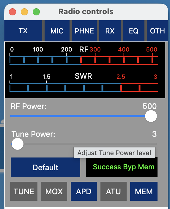

However, I have used the current version with a test unit and it worked fine other than the watt meter was for only 100 watts (not 600 watts as in SmartSDR).
Received my AU520 today. Working well with PC and Mac versions of SmartSDR.
The power meter in the Mac version needs to be expanded for 500 watts. Operating at full power it pins. Setting the RF Power to 20% the power meter indicates 100 watts on SSB peaks
Setting the Tune slider to 10% shows 50 watts which makes sense.
I see the same thing. I hope Marcus will give us an update soon.0

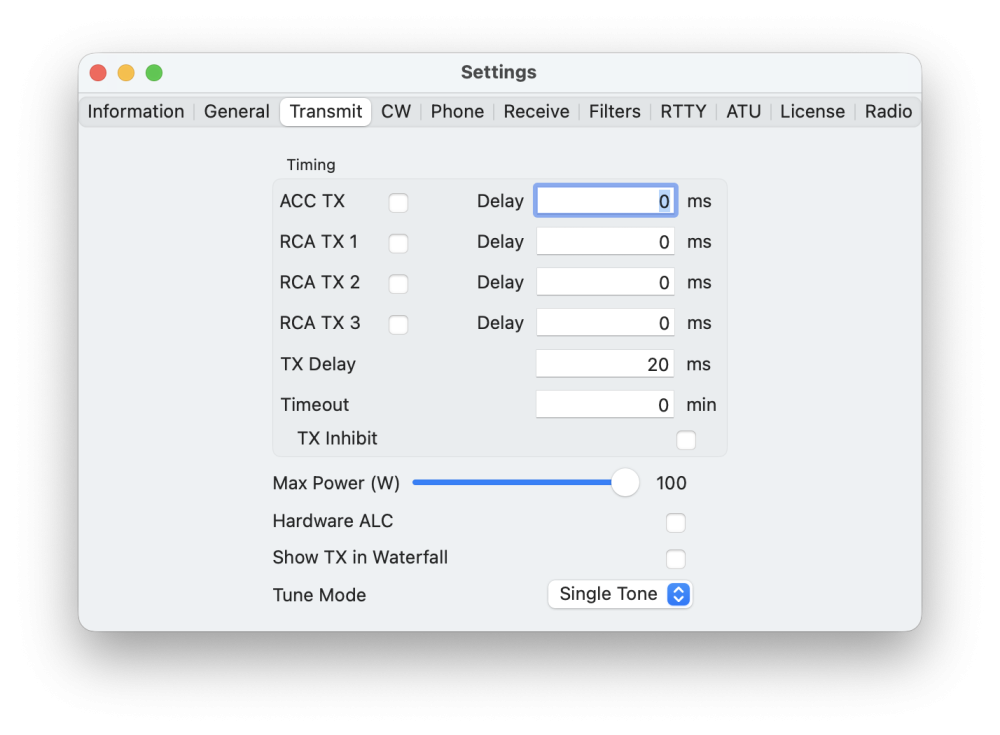

But I am not sure it is working properly, or else I do not understand. Setting the power on the power slider to 500 watts, as soon as I transmit it changes to 100 watts, but the power meter indicates transmitting at 500+ watts.

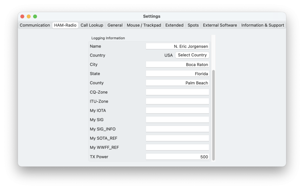

I did set the TX Power in Settings > Ham Radio to 500 watts, and also tried to set it to 500 in the TX Band Settings, but it will not allow setting to higher than 100. Perhaps this is in percent not power?
The power slider is in 100%, not wattage. I am not sure on the Settings menu and maybe that should not displayed in wattage. You may wish to check with Marcus.

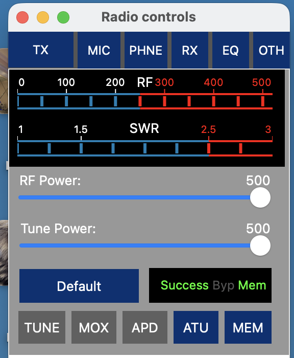

If it is in percent, it goes to 500%!
It does seem to work in percent up to 100, but why it then goes on to 500 is strange to me.
Sliding Tune Power from zero to 100 gives a uniform and linear increase up to 500 watts on the output meter, continuing from 101 to 500 does not increase output power.
Perhaps the power setting in "Settings" is just informational?
