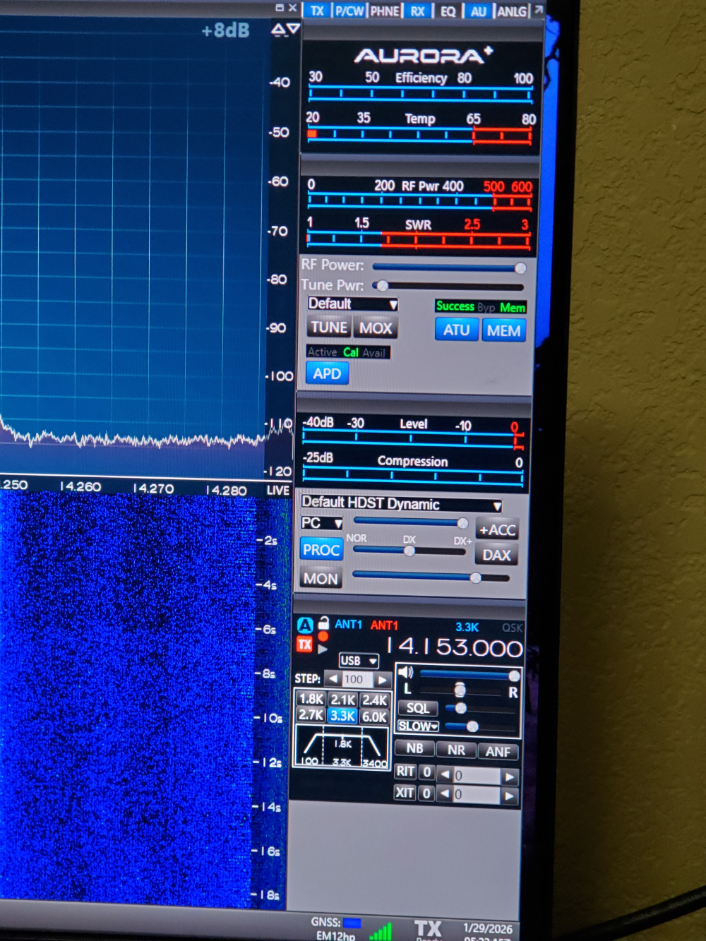

In the above photo, the Tuning step control is just above the Filter selection buttons. It has a left arrow and right arrow that you can click to increase or decrease the Tuning Step of the VFO.

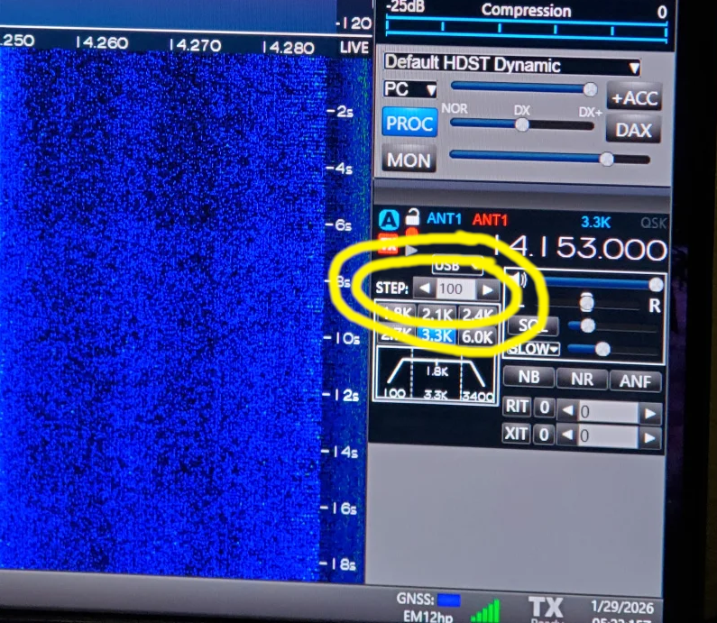

Adding a bit of focus to James' image:
Great Doug i'm glad you found the correct panel i don't think I'd call it a widget as they can't be placed all over wherever you want. They stay in the radio main panel and the buttons on the top allow you to open only the items you need. What i like about it is you can break the radio control panel free from the panadaptor completely... i actually place mine on a separate monitor from the panadaptor. With DDUtil that while no longer being updated, it allows me decent control of my Alpha 9500 including power control and monitoring. Pretty handy. If you look on the K0DD qrz page you can see how i lay out my station ive had a couple 6500s only one now... but can fully control the station 160 through 2m from the op chair... glad i could help. Erika K0DD Small town NW Iowa.
