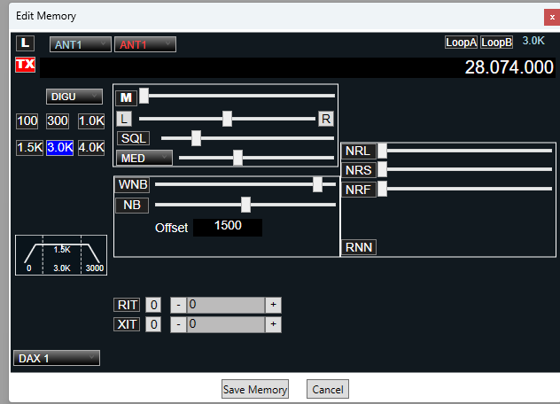

    Another option is the memories in FRstack. They store much more information than the the Flex profiles and most of it is in one place.
    I don't think FRStack memories remember power level.

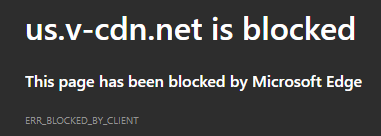

    Mike, this is what I get when I try to access your pdf file.
  • Peter
    Peter Member ✭✭
    Dewey it must be something local to you as the link worked fine for me.
  • Geoff AB6BT
    Geoff AB6BT Member ✭✭✭
    Try a different browser?
