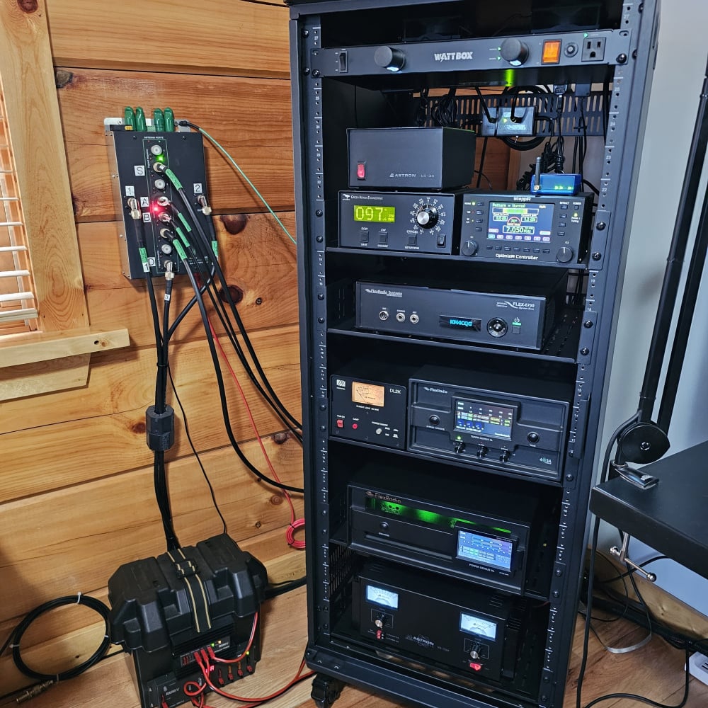

This is by far the best PowerSupply I have used with my entire Flex Station.
Here is a picture of all it easily powers.
