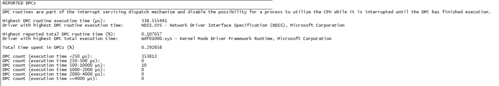

I am not sure what the exact root cause might be but I would look and see what is happening on your computer at the same time. Is there any chance that it is suffering from DPC Latency at all (you can google for tools to check this). Sometimes it is that the computer just can't keep up.
Mike
DPC's
Hard faults

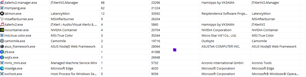

This is what my system shows. Do we see anything that would cause this issue? This is with three instances of WSJT-x running, with JTAlert running on all three. Smart SDR running, N3FJP log, Outlook mail, two tabs of the Edge web browser open, numerous other background apps and processes running. 15 Apps, 135 Background, CPU averaging 10%, GPU at about 15%.
Sorry for the small screen shots.
George N1NAZ
