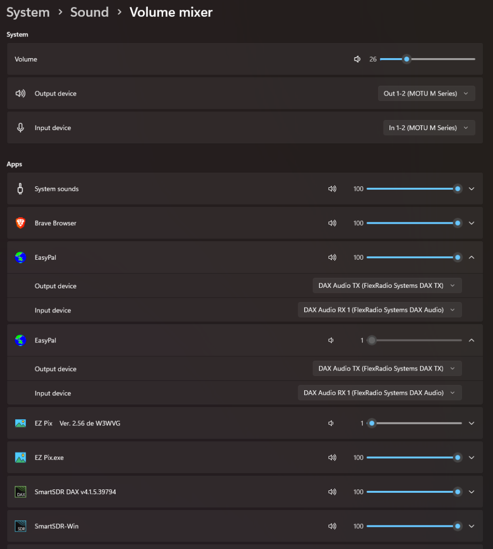

Well, for an unknown reason EasyPal stopped working. I also have the same problem listed above where I seem to be missing the RX1 and TX1 channels. They are not even listed when I attempt to assign them in EasyPal. Oddly, MMSSTV and FLDIGI list them and both those programs operate perfectly. I've uninstalled SmartSDR and EasyPal several times, but still have not had any success. This all happened after I upgraded to SmartSDR version 1.43.11 yesterday. As mentioned earlier, the other two digital software programs work fine. I'm totally lost...again.0
DAX AUDIO TX does not show up to select. I am running Windows 11.
If you open EasyPal, then open Windows "Sound Mixer Options" and scroll down to Apps list. Select the drop-down to the right of EasyPal, select the correct TX and RX devices, they will be set to default. You may see another entry once you start the process in the Mixer for EasyPal, just set it as well. Now close and reopen EasyPal, and you will see the option you want at the top of the list.
W0TTP - Scott0 -
