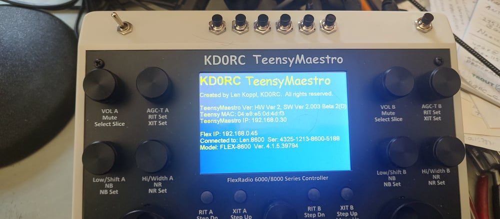

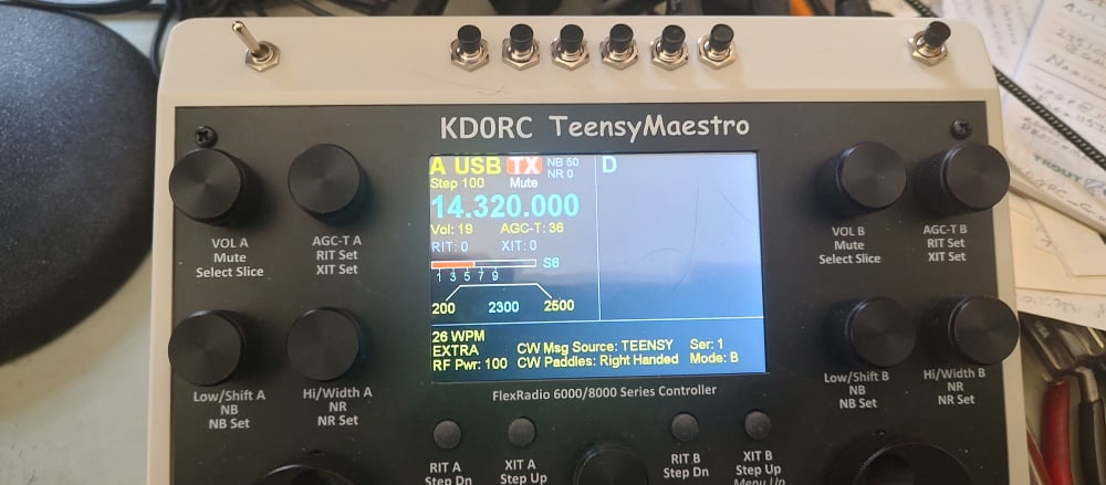

I just finished building my TeensyMaestro (Got the kit from G7UFO). Basically it seems to work. At least it does connect to my Flex 8600. After that it only displays the initial screen. If I touch the screen or any buttons and knobs nothing happens. Neil thought that eventually the display is to tight against the front panel. I removed the front panel, but nothing has changed. Does anybody have an idea what could be wrong?
vy 73 de DF1SD, Kuno0 -
Hi Kuno, did you load HW version 2 to the Teensy?
Hi Len,
yes I did. It is also displayed on the initial screen.

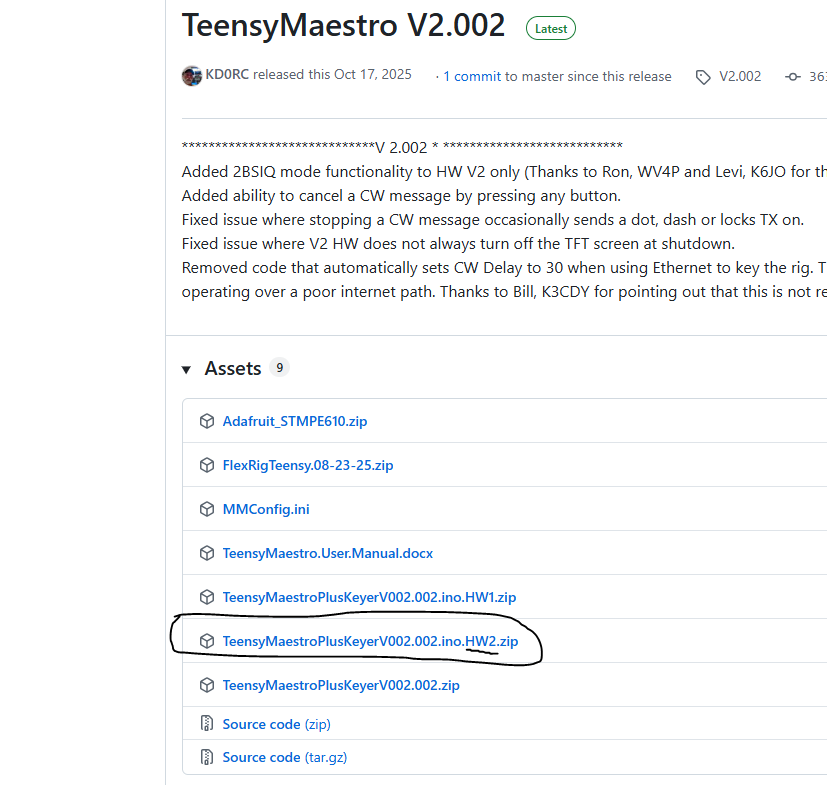

Hi Kuno, Just to be sure, this is the firmware that you loaded, correct?
If that is OK, then let's look at your MMConfig.ini SD card.

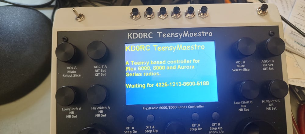

Here is the progression of screens that you should see:
I wonder if you have a stuck button, solder splash, or that kind of thing. Can you verify that you do not have a button that is stuck ON? You might want to completely remove the front panel to be sure nothing is binding.
Also, did you remove the SD card socket from the back of the display?
