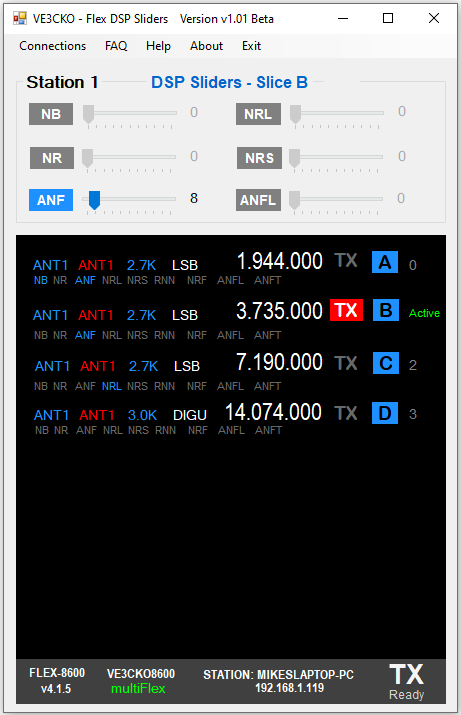

Len, thanks for some of the direction you gave. I've got this app completed, just about ready to release it. Basically whatever slice is ACTIVE, selected by a client or by clicking on slice Letter in the app, you can adjust the DSP levels for said slice as shown. Would you like to test it out ?

A few notes when first loaded it will connect to a radio, and the slices are shown and the Active slice as selected by the client is indicated in green. However be sure to click the slice letter of the slice you want to us as the Active slice so to control the DSP.
The Station 1 in blue "DSP Sliders - Slice A " indicates what slice you can toggle on/off and adjust levels. Again, to change the slice, click on the slice Letter in the slice section below.
RIght now just in slice 0, you can also toggle NB, NR etc. by clicking direction on NB, NR etc. This is disabled in other slices in use for the Beta release.

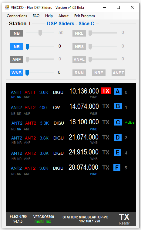

As a result I've come up with a new version 1.03 Beta, I need some immediate feedback as I'd like to do a release ASAP.
Len, I've messaged you v1.03 zipped, the Help and FAQ briefly explain use and known limitations. Not sure if you had a chance to look at previous version so won't go into any details here. Below is an example of a 6700 connected.
