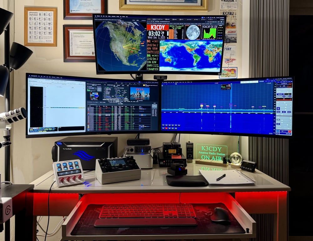

Here's a guide I put together for getting the Stream Deck to work with Mac SmartSDR. I've also included files to replicate my Stream Deck + setup. Have fun!

Actually, I’m working on a version 2 of my guide, which will include a lot of refinements, plus I’ll add an explanation for how to use the .xml file.
Stay tuned!
OK, here's version 2 of the guide. It corrects some errata, offers a more streamlined example profile, information about the CWSpeed.xml translation file, and some suggested application keyboard shortcuts.
