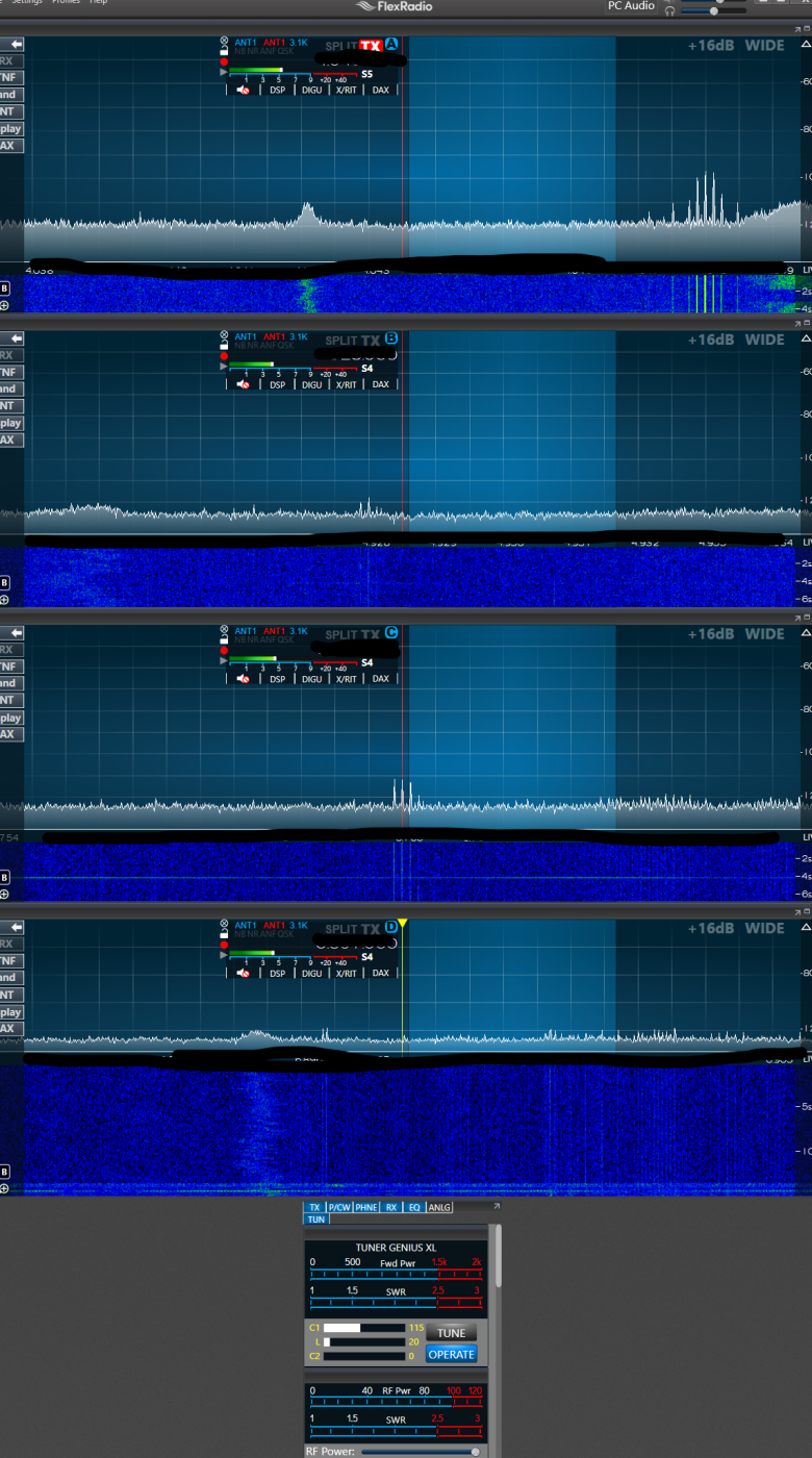

I am running this new fresh install for the first time this morning. When I changed profiles I had the controls from the right go down to bottom, I was able to move back but never have I placed there or anywhere else. Seems like it tried to make it another pan adapter.

When I installed the software I followed the directions fully, allowing extra time i.e. instead of 2 minutes, 4 to 5 minutes. I did a FULL reset, as I always do. White button and all. So a clean new setup with nothing retained. I did not import ANYTHING. I created every profile, as I always do, from scratch. After that was all done I did everything all over except for the "white button' factory reset. Shut down, waited 4 to 5 minutes, removed power cord, waited about 4 minutes, attached power cord and switched on the power supply, waited about 5 minutes, ran SDR software. Let it sit there and burn in for a while, I think 30 minutes as I went up stairs to eat. Came back down, changed profiles and boom had the side window on the bottom, I can move it back to the side, however, every time I switch to a profile with the four (4) pan adapters it moves it to the bottom, every time.
As I finished typing I tried again and did not do that for 3 times, then started doing it again. So apparently not EVERY TIME but pretty much every time after those 3 times it started back up again.
