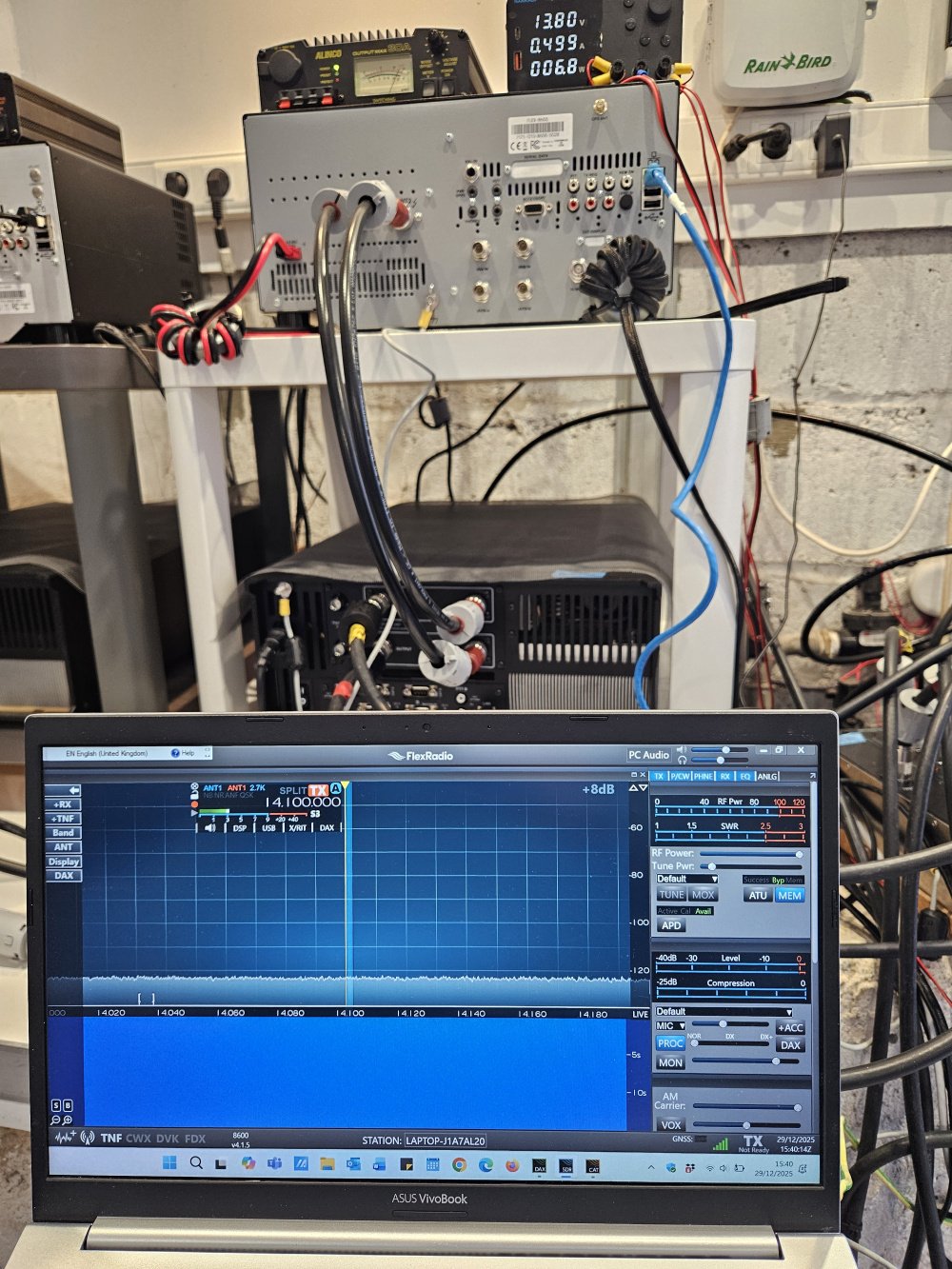

If upgrading from 3.9.19 to ANY V4 the 8600 immidiatelt shows the INTERLOCK error and the TUNE and MOX buttons remain grey. Resetting the redio did not help. It only works on the pre V4 versions. NB. The other Flex - 6600 does not have that problem running the V4.
Thank you.
Flex 8600: only transmit under the V4 versions of the firmware. Namely, the buttons Tune and Mox are grey under the V4 (like the current one 4.1.5) as well as there appears the "Interlock" issue warning. Downgrading back to 3.9.19 does cure the issue. My other Flex 6600 works fine with the 4.1.5 ! HELP please

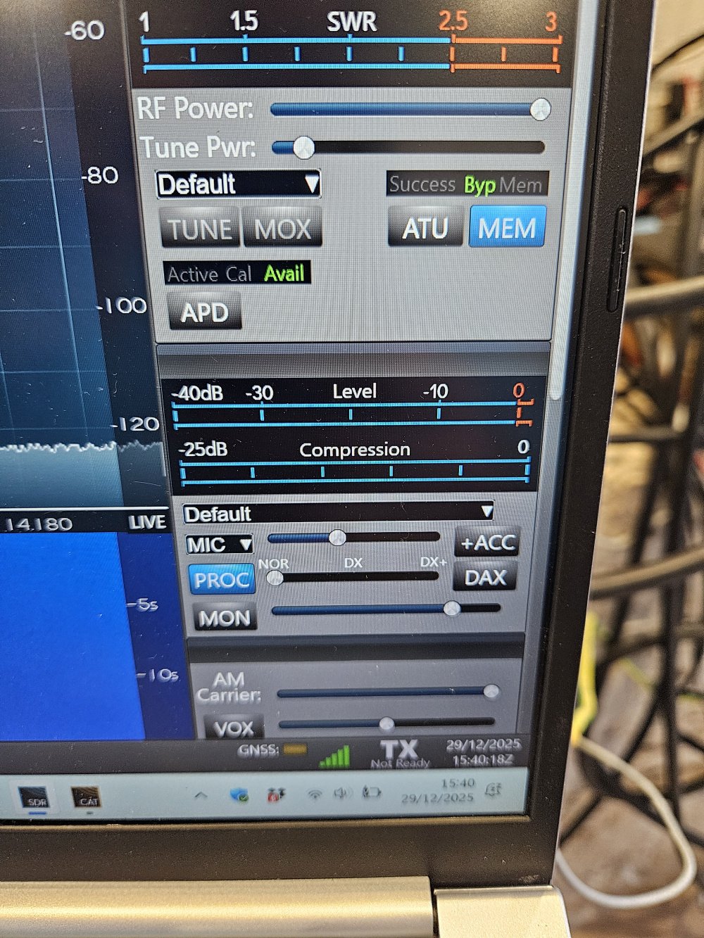

No, it did not help: Tune and Mox are grey, and when attempting to click on the ATU on 8600 the interlock message comes up.

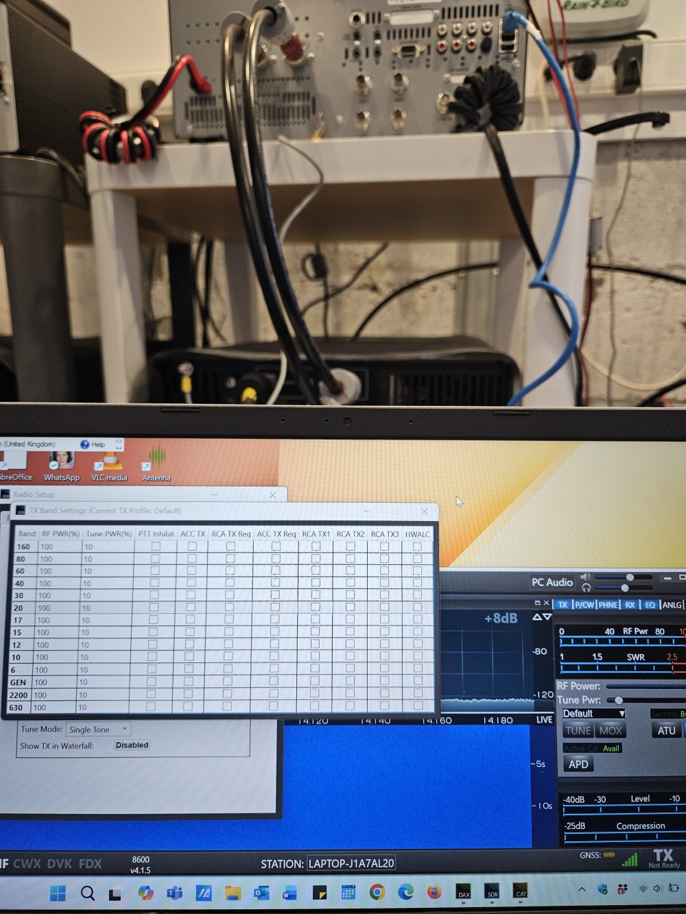

Tried to run the 8600 on a different PC where thee 6600 is connected (the 6600 works fine with any V4) - same result - grey TUNE / MOX…
Tried the 88600 on the 3rd independent PC - same story - Tune and Mox are gret. PTT inhibuit etc are OFF.

they are not greyed out, they are just not active. Click one and you should see the radio go into transmit.Sorry, I just saw the Not Ready indicator. Hopefully Flex support will be able to help.

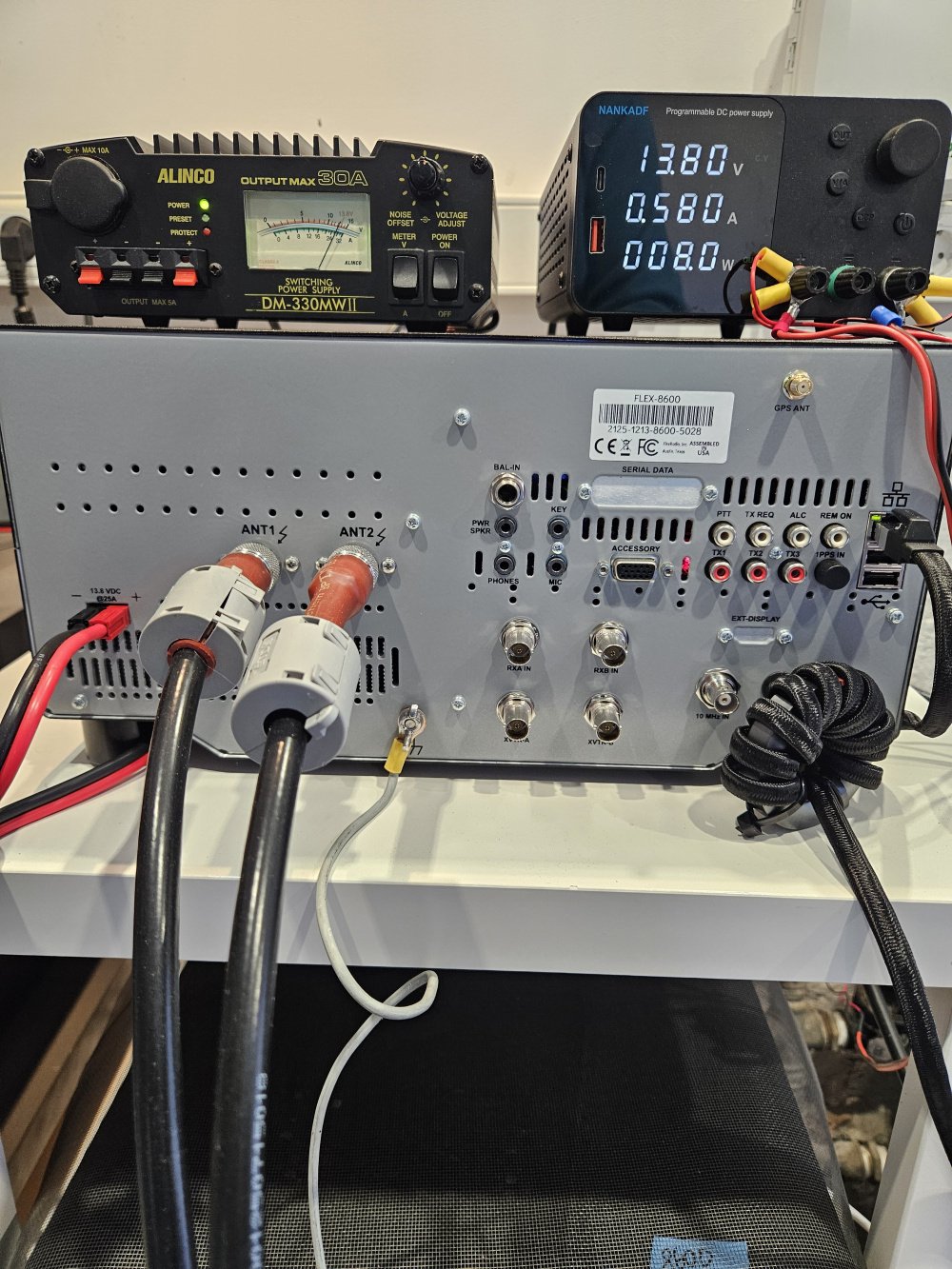

On another topic - I would remove the ferrite beads from your ground wires. With them on there, they provide a DC ground, but not an RF ground which is their intended purpose.
